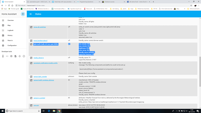

no i’m not sure of anything if Im honest, i tried looking at the states page in HA under the dimmer switch and all I see is this:
[sensor.tradfri_wireless_dimmer]
(http://hassio.local:8123/dev-state#) 74
manufacturer: IKEA of Sweden
model_number: TRADFRI wireless dimmer
serial:
firmware_version: 1.2.248
power_source: Battery
battery_level: 74
unit_of_measurement: %
friendly_name: TRADFRI wireless dimmer
if I turn the dimmer (even when it was paired with the bulb via the tradfri app) nothing on the states changed except the battery percentage, though the bulb would turn on and off and get brighter or dimmer. as it stands just now with the switch not paired, it does nothing at all.

Those two things don’t seem to line up.
you are calling it a switch (which would also be my understanding of a device that controls the dimming) but you are showing a sensor (which is a device that detects some thing.
Can you take a screenshot of the dimmer and post it here?
What you are listing above looks like the attributes of the dimmer not the state.
Ahhh… never noticed that…

the “sensor” i’m trying to use is this
https://www.ikea.com/gb/en/products/lighting/smart-lighting/trådfri-wireless-dimmer-white-art-00347831/
hope that helps
you cut off the top of the dimmer in your last pic. please try again showing the whole dimmer section.
I have an idea what you need to get started but I want to be sure.
sorry about that,
here you go
OK, from that screen shot you can see that the “state” (middle column) of the dimmer is “60”.
So, try this and see if the light turns on when you take the dimmer from all the way off (‘0’) to something higher (>‘0’):

nothing happend, that value ‘60’ appears to be the battery percentage as the two values are always the same

If you operate the dimmer device the number in the “state” column doesn’t change?
thats correct
