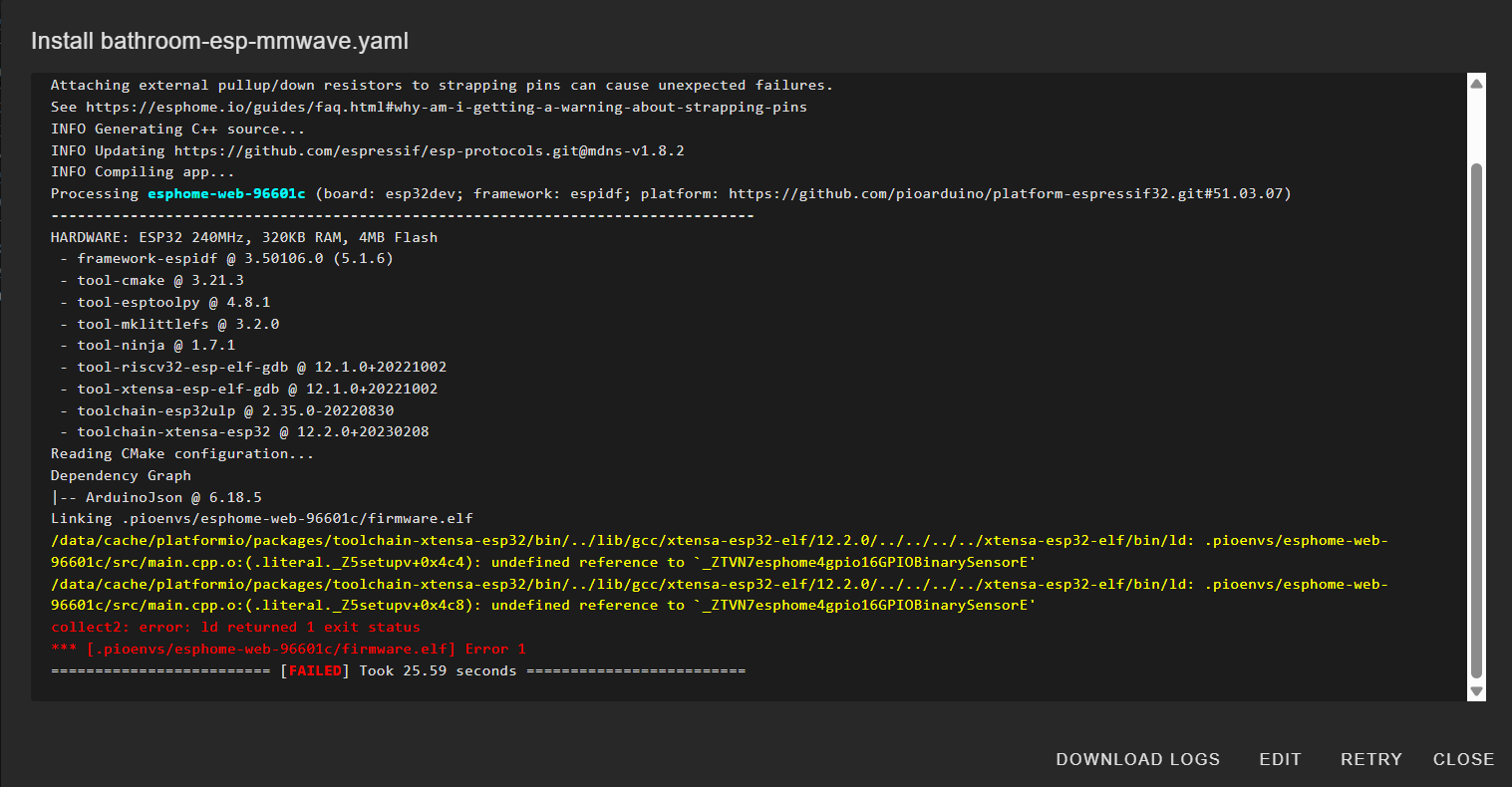

So I have the ld2410c working fine. When I try to add the PIR to the yaml, it fails. It won’t install the new configuration. Here’s my yaml

Everything works for the mmWave but when I add the last platform of gpio with pin 13, I get this error when uploading
