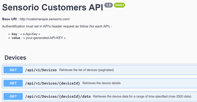

I have an optical sensor that counts people. It is capable to count adults and children entering and exiting. The typical application is mounting the sensor overhead above a doorway and count people entering and exiting. The sensor has an API that I generate and online developer documentation available if you have account log in credentials.
Attached are three screenshots from the online documentation related to the url needed but I’m not understanding how to craft the yaml language in HA. For now I’m mainly interested in the counting and once I can understand how to get this working I will monitor other attributes.

Try it using the new rest integration. You can create many sensors from the one call to the resource with this. Unlike the restful platform that requires a call for each of the sensors you create. This will cut down the chance of any API limit being exceeded or reduce your need to create template sensors if you grab all the measurements at once as attributes.
You need to add the device id in the resource and put your key in the headers:
rest:
  - resource: http://customerapis.sensorio.com/api/v1/devices/YOUR_DEVICE_ID_HERE/data
    headers:
      x-API-Key: YOUR_KEY_HERE
      Content-Type: application/json # May not be required
      - name: "LZR-SIGMA_8 Count A"
        value_template: "{{ value_json.measurements[0].countA }}"
      - name: "LZR-SIGMA_8 Count B"
        value_template: "{{ value_json.measurements[0].countB }}"
      - name: "LZR-SIGMA_8 Count Child A"
        value_template: "{{ value_json.measurements[0].countAChild }}"
      - name: "LZR-SIGMA_8 Count Child B"
        value_template: "{{ value_json.measurements[0].countBChild }}"
I may not have the path to the values correct in the value_templates. You can use this tool to check:
https://jsonpathfinder.com/
Paste your example data in the left hand column and drill down to the measurement you want in the right hand column. The path is at the top of the right hand column (replace “x” with “value_json”).
