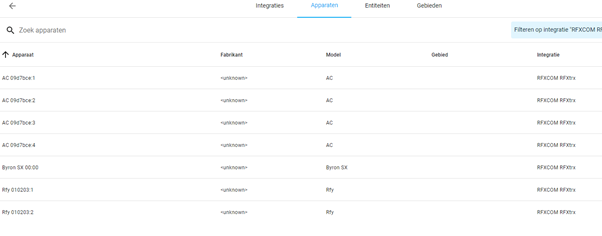

adding the device manually did the trick! seems like the rfxtrx config in the configuration.yaml doesn’t work in combination with the rfxcom intergration.
