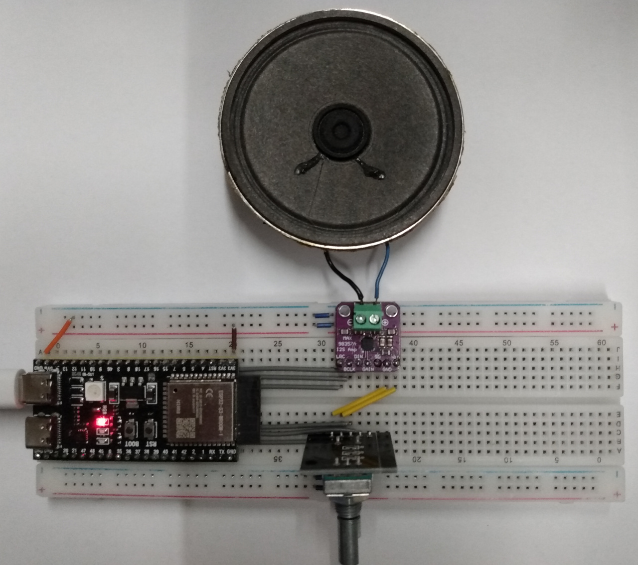

I’ve been playing with an esp32-s3 and MAX98357A i²s DAC/ AMP today, so that part is kind of easy’ish (should be relatively similar on the ESP32-C3, but I would be concerned about the ESP32-C3 performance for this task as well):
substitutions:
  friendly_name: esp32-s3
esphome:
  friendly_name: ${friendly_name}
esp32:
  board: esp32-s3-devkitc-1
  flash_size: 16MB
  cpu_frequency: 240MHz
  framework:
    type: esp-idf
    sdkconfig_options:
      CONFIG_ESP32S3_DEFAULT_CPU_FREQ_240: "y"
      CONFIG_ESP32S3_DATA_CACHE_64KB: "y"
      CONFIG_ESP32S3_DATA_CACHE_LINE_64B: "y"
psram:
  mode: octal
  speed: 80MHz
# Enable logging
logger:
  hardware_uart: USB_SERIAL_JTAG
# Enable Home Assistant API
api:
  encryption:
    key: !secret esp32-s3_api_key
ota:
  - platform: esphome
    password: !secret esp32-s3_ota_password
wifi:
  ssid: !secret wifi_ssid_wpa3
  password: !secret wifi_password_wpa3
  ap:
    ssid: "Esp32-S3 Fallback Hotspot"
    password: !secret wifi_password_fallback
captive_portal:
web_server:
  port: 80
i2s_audio:
    id: i2s_audio_bus # For speaker
    i2s_lrclk_pin: GPIO16
    i2s_bclk_pin: GPIO15
speaker:
  - platform: i2s_audio
    i2s_audio_id: i2s_audio_bus
    dac_type: external
    i2s_dout_pin:
      number: GPIO7 # DIN Pin of the MAX98357A Audio Amplifier
    channel: stereo
    buffer_duration: 1000ms
media_player:
  - platform: speaker
    volume_min: 0.5
    volume_max: 0.8
    announcement_pipeline:
      speaker: box_speaker
      format: FLAC
      sample_rate: 48000
      num_channels: 1  # mono, single MAX98357A
3 GPIOs needed:
  • GPIO7: DIN
  • GPIO15: BCLK
  • GPIO16: LRC(LK)
GAIN and GND connected to ground, VIN and 5V connected to 3.3V.
//done.
Useful schematics: https://cdn.static.spotpear.com/uploads/picture/learn/ESP32/ESP32-S3-1.28inch-AI/ESP32S3-1.28inch-AI.pdf
Interesting read: SpotPear "DeepSeek Voice Chat" config
Ignore the rotary encoder, that’s still a work in progress.
Sound quality, not great.
Volume, too low (active speaker needed).
Works.

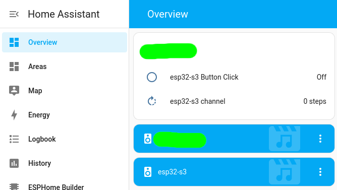

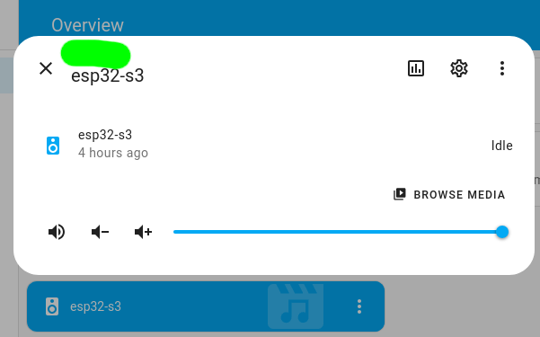

I had ordered the same S3 module you have shown, and it’s due to arrive today, so will give that a spin. I have some C3 Zeros available so used one as a test.
a (possibly daft) question; When you add this in Home Assistant, how do you actually interact with it? does it just show as a regular media player entity?
Yes, it does.
