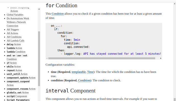

Chatgpt is great if you never want to learn or understand what you’re doing and enjoy being clueless. There is a wealth of documentation on https://esphome.io/ that explains automations and gives you lots of examples. The automation you need is a very basic one and there are pretty much examples alone that would meet your needs. You just gotta try, that’s it. Show that you are trying to learn it and make an effort and people are more inclined to help that person over chatgpt person.

So those terms are just for telling esphome what it is you are commecting to it. So a “sensor” can be a lot of things but overall its an input for a gpio pin. Whichever platform you use will determine what kind of functions are available to use. So, a binary sensor for example is the same, its a gpio input(the esp is expecting to receive a logic High or Low) its binary sp thats one or the other, On or Off, High or Low.
A “sensor” alone is more of a generic term unlike binary sensor where it only accepts High/Low. A generic sensor can be used to program a gpio input for all kinds of physical sensors that send analog signals, digital, they csn be used for a sensor like a temp sensor that will give you numbers (72.0 deg.). Its more or less a “catch all”
