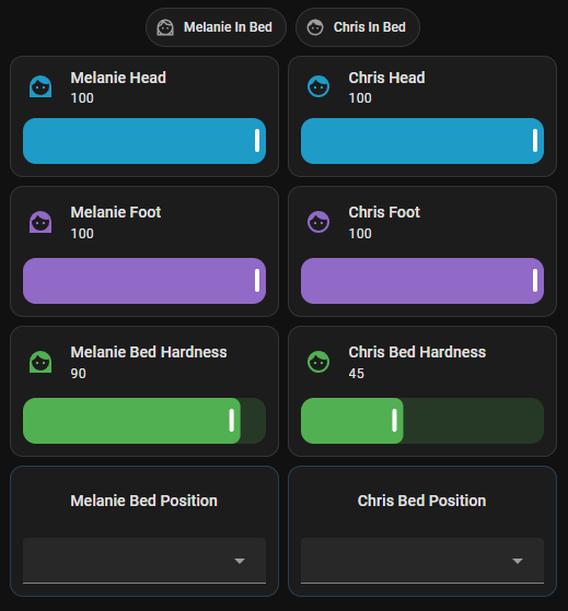

Greetings,
So I have a dashboard, which I patterned after this one for my Sleep Number bed.
It looks like this:
Everything works great, with one caveat. The bed takes some time in conducting changes, and if another button is pressed while a change is ongoing, the change immediately stops and then switches to the new command.
Is there a way to “disable” the other commands whilst the bed is doing it’s thing?
Here is the YAML:

Instead of changing the entities directly you could have the button execute a script passing the entity, then set the script to queued mode. This would ensure the first operation completes before the second executes. If that doesn’t work natively, you could add a delay to the end of script to ensure there is a time delay between executions.
Ok.
This is definitely new territory for me. I’ll have to look into it.
A delay is not the ideal way of doing this, as some processes take an indeterminant amount of time.
Thanks
