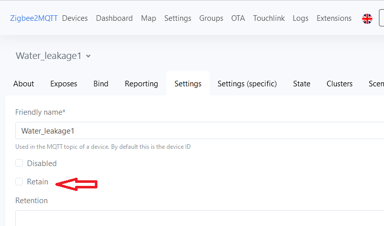

NB: If you are working on equipment with interface try to activate the “retain” option.
Hi, sorry I know this is an old topic but where did you find this mqtt code? I’ve been looking in file editor but can’t find a similar mqtt object like yours. The only mqtt I’ve found is in my Zigbee2MQTT config file but I don’t know if that needs retain added to it or where to add it if so.
