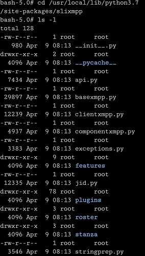

And to be sure you did it right, can you give me the output of this (while still in the docker container):
cd /usr/local/lib/python3.7/site-packages/slixmpp
and then
ls -l
Now hass is started again, then no error… but this is output:
That can’t be right. The time says 08:13.
Please try one more time
pip install --upgrade git+https://lab.louiz.org/poezio/slixmpp.git
and then check the time again. They need to be updated, so also the time will change to now.
Now better… will reboot again
