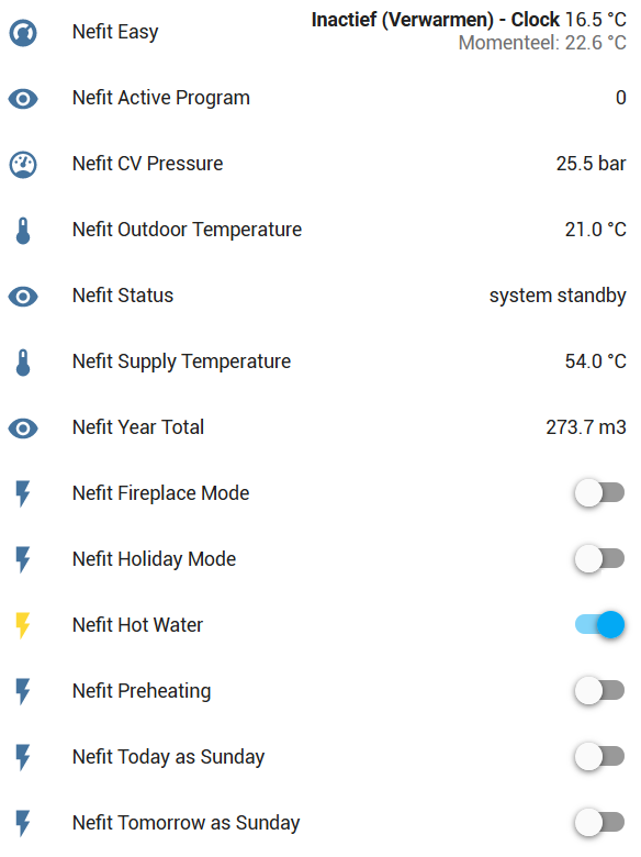

First version with switches and sensors of the new component.
The files can be found here: https://github.com/ksya/ha-nefiteasy
Please report any problems here, or (preferably) make an issue on Github.

Could you also share that lovelace config?
This is all I ever dreamed of (Nefit-wise speaking
Thank you so much!
And I love to see that lovelace config too.
I used the monster card with an entity filter:
- card:
show_header_toggle: false
title: Nefit entities
type: entities
filter:
include:
- entity_id: '*nefit*'
type: 'custom:monster-card'
I think you hoped for a complete list? You can see all entities when you search for nefit in the “states” tab of the developer tools
