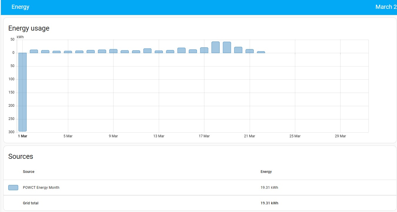

Hi All, I am new to this Home Assistant so I am just finding my feet. On my energy dashboard, I have a negative value on the first day equal to the total energy of the last month. I have no idea how to change this and would appreciate
some assistance. I am certain that it is an easy fix.

From the image in your original post, it looks as if you are using a sensor entity (POWCT Energy Month) that resets to zero every month. You need one that increases continually.
The problem is to do with a wrong state_class on your sensor, combined with the fact that it resets. The resetting itself is not per se bad, but it is when it does not match the state class.
  1. Is the sensor you use one you created yourself (e.g. via a template) or from n integration?
  2. Can you show the entity you use in the developer tools?
@Edwin_D is already going in the right direction, but to fix your history got to developer tools, statistics and click on the graph icon of the entity. Then you either can look for Outliers or set the time and date to the 1st of March (you max need to cycle through multiple time settings to find the right one). If you see a negative value simply set it to 0.
For the state_class you need to read this Energy Dashboard shows odd entry on graph after midnight - #5 by karwosts
If none of this applies to your sensor, use customize.yaml to overwrite the state_class.
