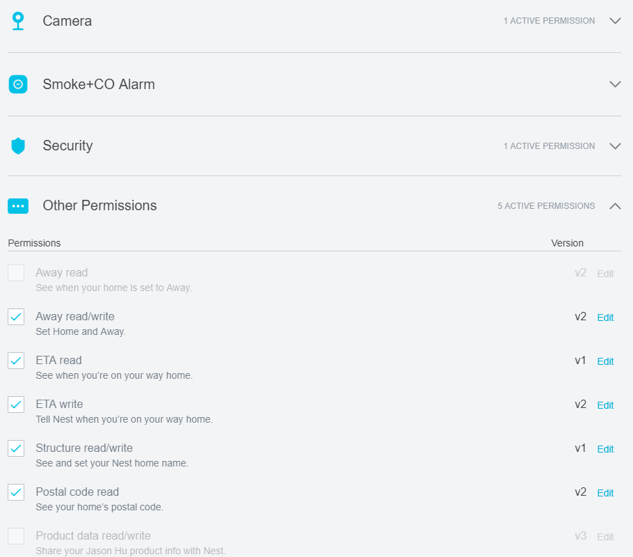

Also please let me know what Nest products you have.
I am guessing you don’t have Away read permission for your nest developer account.

Away read permission is under “Other Permissions”
