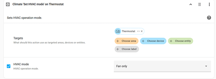

Well I might have been incorrect. I did not see the option for fan only from the dashboard, but now I see that it looks like you can do it from an integration. So I guess it comes down to how you might want to use this.
I can try this out later and let you know if it works.
EDIT. should have said automation not integration.
Ok, it is possible to use fan only, I just got it to work with an automation.

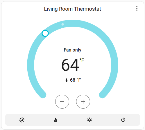

Thanks for testing in automation. Question: how can you control the fan from dashboard?
Hmm. Mine lets me perform this Action, but the fan doesn’t start and I don’t get your fine blue “fan only” mode in the panel. Is this what your climate entity attributes look like?
