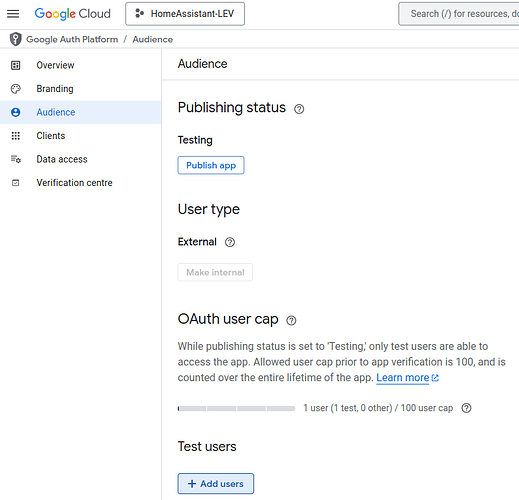

It appears the Google Cloud Console is updated. Any advice on where to add the test user now?
I had to do the following to get it to work for Google Drive
After setting up the client and the OAuth credential,
From APIs and Services section (Search for it in the top bar if you can’t find it),
on the left hand menu click “OAuth consent screen”, it will redirect to Google Auth Platform / Audience,
on the left hand menu click “Audience”,
Under Testing, click “PUBLISH APP”
Click Confirm
This worked after a few more tries!
Thanks.
Not sure why google kept emailing my girlfriend about this (probably something to do with my google acount on her chromecast) but I’ll let it slide.
THX for the tip, Google change their stuff quite often.

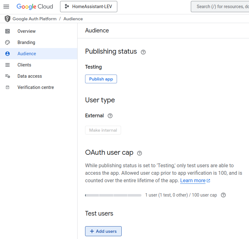

Here a screen shot:
publishing did the trick for me. thank you!!!
