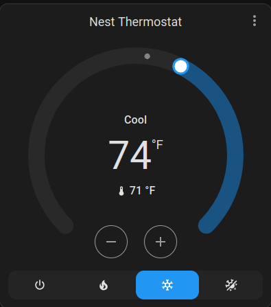

Can confirm: I have a new Google Nest Thermostat working over matter while disconnected from the internet. Only been testing for an hour or so, and will reconnect to the internet (thermostat provided gratis by the power company, so they want to see it online) but I’m pleased to see matter working for local control.
Here are the entities it enables:
* climate.nest_thermostat
  * hvac_modes: off, heat, cool, heat_cool
  * min_temp: 50
  * max_temp: 90
  * friendly_name: Nest Thermostat
  * supported_features: 387
  * current_temperature: 71
  * temperature: 74
  * target_temp_high: null
  * target_temp_low: null
* sensor.nest_thermostat_temperature
  * state_class: measurement
  * unit_of_measurement: °F
  * device_class: temperature
* switch.nest_thermostat
  * device_class: outlet
Does not appear to allow fan control (still testing) but I can change the temperature and on/off/heat/cool. The matter linking process was a little convoluted, as I had to fiddle with both the Home Assistant Companion app and the Google Home app (can’t find the matter pairing code anywhere, so I’m guessing the Google Home app is hiding this) but at the end of the day I have local control!

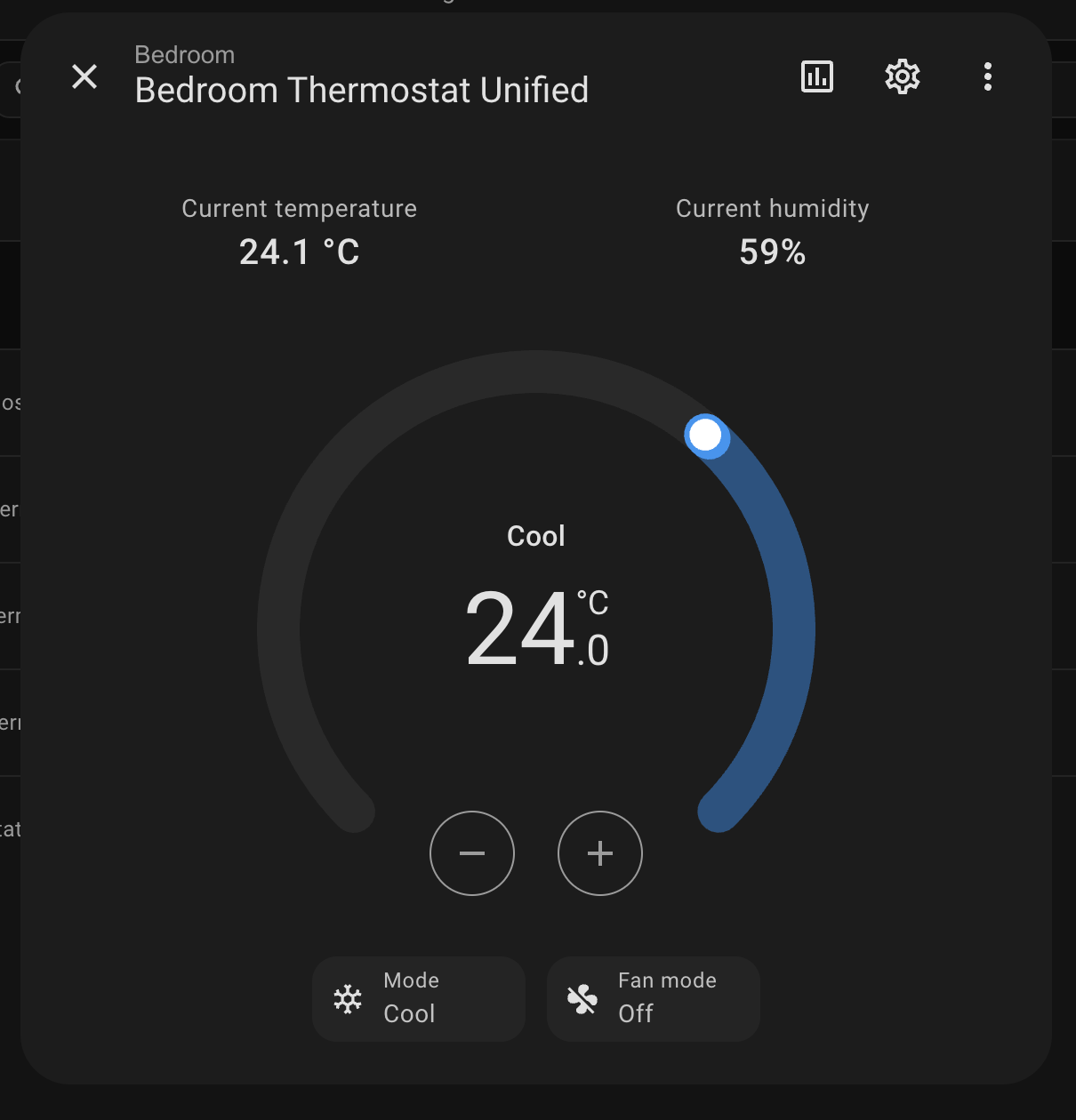

I just purchased 5 of Nest 4th gens and made a simple integration - GitHub - darki73/hacs-nest-matters: Combines Google Nest and Matter thermostat entities into a unified Home Assistant climate control interface
Problem is, matter only exposes temperature setting and the reading, and thats it. This component aims to merge the Matter + Google Nest integrations, so you can have fast and unlimited temperature control (via Matter) and then for other features use the super limited (5 queries per minute / 100 per hour) Google Nest integration.
The combined entities will appear as a separate climate devices.
And then the temperature control + reading are provided by the Matter part, while the rest is routed through the Google Nest (you wont be changing modes very often, so i guess this is the best of 2 worlds)
I have a basic HVAC system that only allows to cool and control the fan mode (air recirculation while not cooling)
