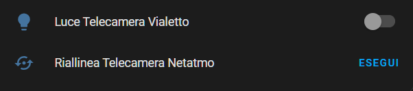

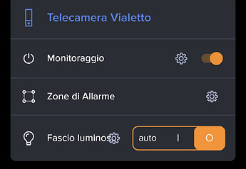

But I’m getting the lights not available, what could I do?
I removed the complete integration, credentials etc., no webhook was in HA, nothing in config.
Rebooted, checked the portal, wait for 1h, checked the portal for unbanned.
Integrated netatmo vi integration and web out on the netatmo page, everything beside the lights is working.
What could I check to get the lights working?

Thx for your reply!
The web hook was not banned. But it is working again. Ik removed the button from my dashboard and readied it and it works again.
