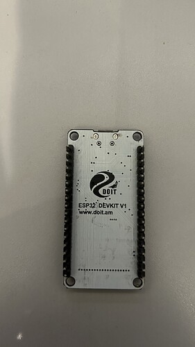

OK, solved It seems quite sensitive to the hardware used. The ESP32 board shown below just doesnāt pick up a Netatmo smoke sensor, although it is able to connect to my toothbrush over BLEā¦
The ESP32-S board shown below immediately picked up the Netatmo smoke sensor as a Homekit device in Home Assistant and after entering the pairing code it was adopted. Could not be easier!

Thanks for the info, Iāve tried two different ESP32 boards now and neither work (the one is the exact one you had trouble with). I found a local place that sells the NodeMCU one and itās on its way, hopefully will have better luck with it.
This is the other one that didnāt work:
