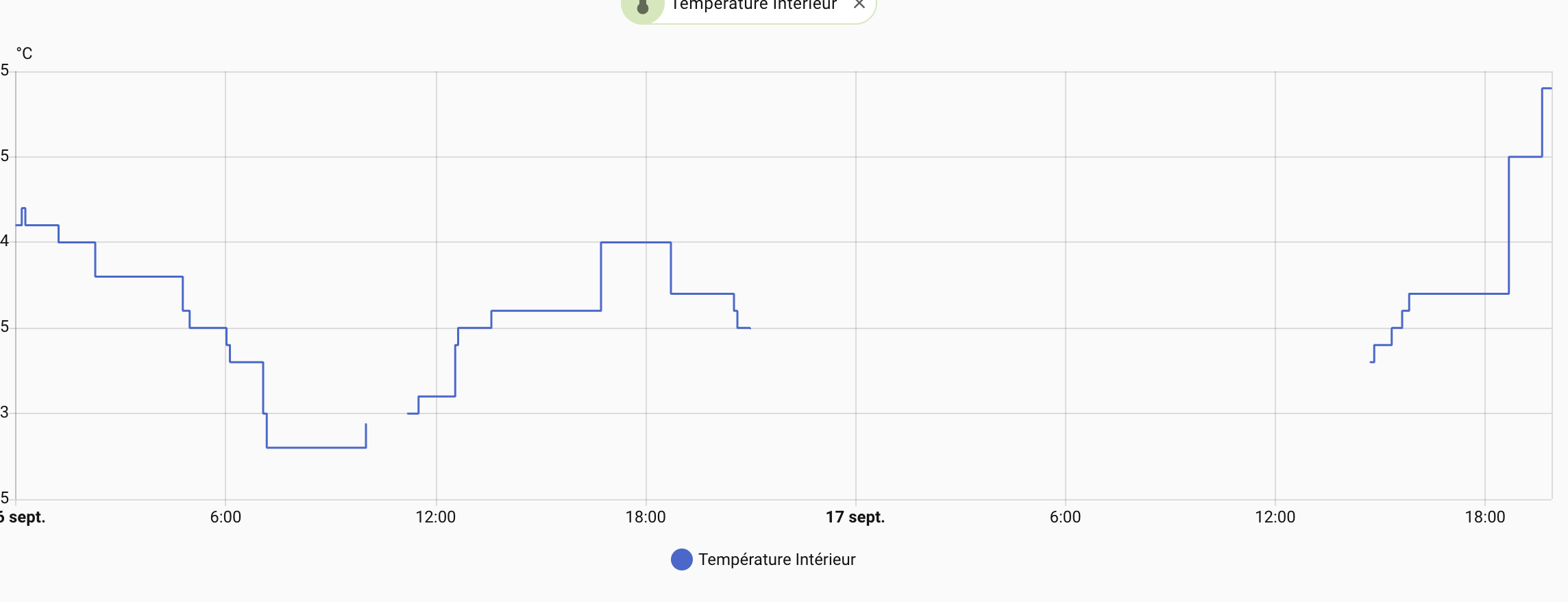

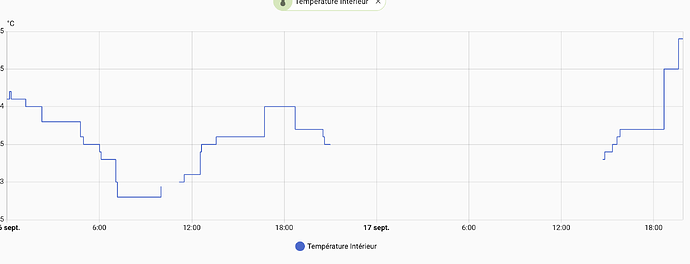

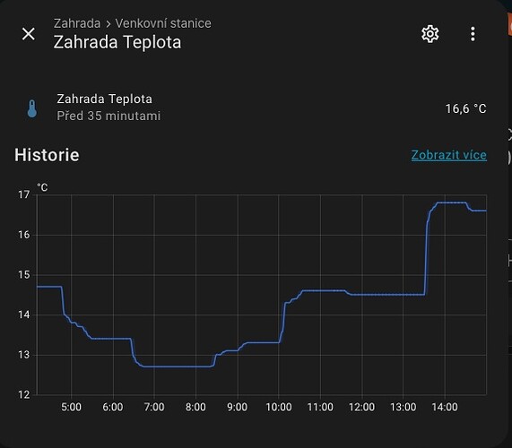

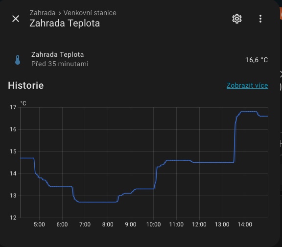

I attach history screenshot of one of my Netatmo sensors updated 35 minutes ago. When I check in Netatmo app, data refreshes each 10 minutes.

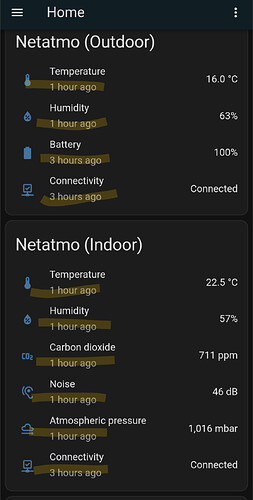

OK, so this is a standard behaviour of Netatmo HA integration, that values are updated once per 1-2 hours? I was thinking, if I have something broken inside my HA installation / configuration. I think yesterday or previous day all Netatmo values were updated like each 15 minutes…
So for now I have not received fresh data for 3 hours, this could not be normal, when I reloaded the integration, it updated immediatelly. I dont think this is normal behaviour, Netatmo API is working, I fetch the data also through NodeRed for other projects and it works.

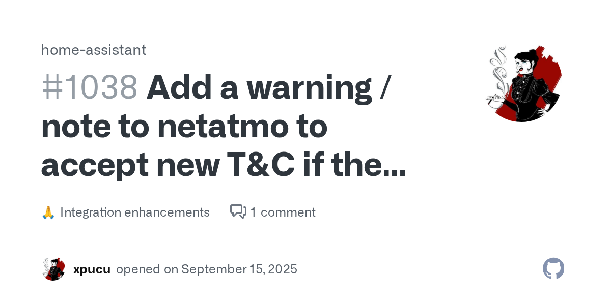

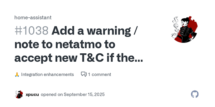

FYI have you seen this? It’s a feature request, but it’s alluding that there were netatmo changes. These changes may be affecting you at the moment.

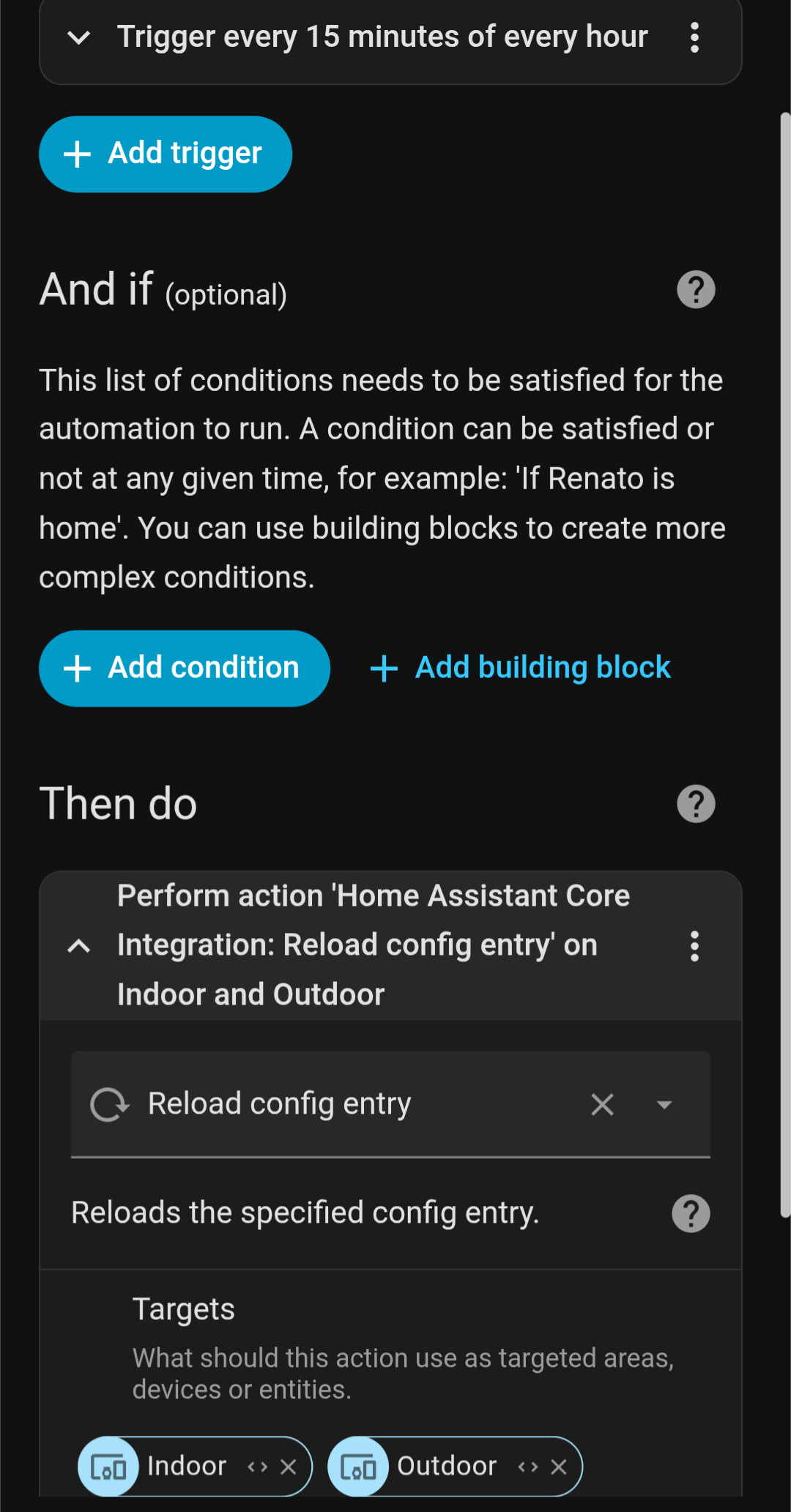

An workaround forcing to reload the entities is working:
Yes, I saw that, accepted TC but nothing changed.
Thanks for reporting that, but they close those tickets immediately, I have searched for other ones closed with same comment - it is expected behavior. Than it quite don’t make sense to have weather station integration where values update once per 3 hours :frowning: I have forced reload_config if value does not change for 30 minutes and it seems as suitable workaround for now.

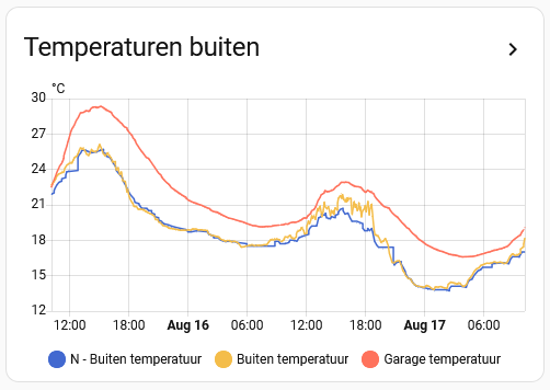

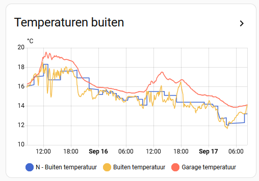

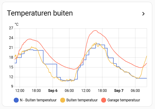

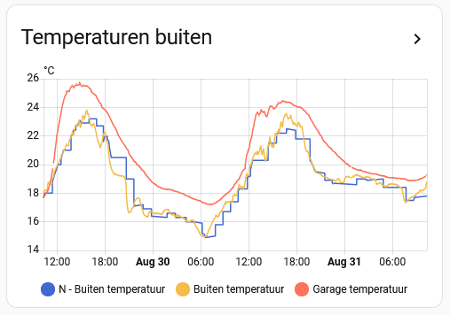

This are some screen grabs from some of my outside temperature sensors showing this effect during the last few weeks:
The blue values are from my Netatmo outside temperature sensor.
