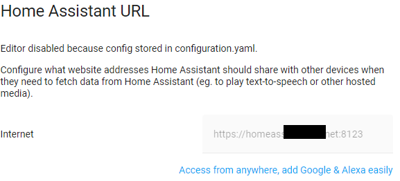

I’m not positive this resolved my issue (I haven’t backed out the change to confirm that it fails again), but I added the following to the homeassistant: section of my configuration.yaml:
homeassistant:
  external_url: "https://homeass.abc.net:8123" '
Note: you will need to change the homeass.abc.net to be whatever your actual DNS name is .
I then restarted my homeassistant server and now I can once again connect to HomeAssistant using the app on my phone and connected via 5G (i.e. the internet).
It still says “External Access Disabled” from the system screen:
It also says “Editor disabled because config stored in configuration.yaml” so I assume it’s using the change that I made:
I’ve attached some images… not sure if they worked.
