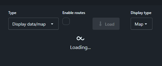

I fail to see the network map.
When I installed z2m, map worked well, but after few times, it failed. I’ve update several versions since the failure but it didn’t solve the issue.
when pressing the load button, I got the infinity sign running for quite a while (estimation ~2 min) but nothing is loaded.
during the map query phase I get few error messages in the log:
[25/02/2026, 23:13:06] z2m: Failed to execute LQI for 'Living room led light'
[25/02/2026, 23:13:33] z2m: Failed to execute LQI for 'bedroom large roll curtain'
[25/02/2026, 23:14:29] z2m: Failed to execute LQI for 'Garden up switch'
[25/02/2026, 23:14:58] z2m: Failed to execute LQI for 'Garden down switch'
I have tried few browser and clearing the cache, but nothing worked.
I have ~25 zigbee devices
Is there some idea to help me? reinstall from scratch?

Waited till it timed out, about 2 min
I run it a multiple times over the last few months from multiple devices and multiple browsers
The server is a NUC alike. Beelink Mini S12 Pro Mini PC, Intel 12th Gen Alder Lake- N100(up to 3.4GHz), 16GB DDR4 RAM 500GB PCIe SSD
