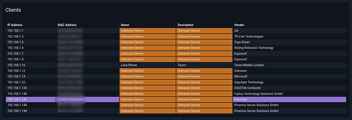

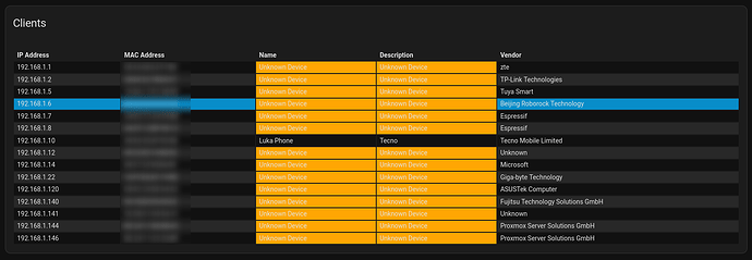

To expand upon this card, I modified it a little bit. I did see that TD has a margin left/right so text in div, especially in multiline isn’t centered and there’s a small gap. I changed the div into a span and used the selector on the TD when there’s a span.warning-cell present inside of it.
The colors are also dynamic now so it’ll follow your theme nicely:

Very nice! I cannot wait to try this. I had to restore my HAOS and the network scanner has not properly initialized since, so once I get through that, I will try this.
After restoring my HAOS I was able to get this change in the card. It’s awesome! Any idea how to add device count to the same card?
