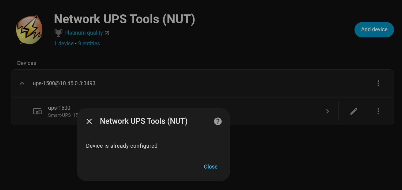

Did you configure this through the UI? I don’t see any instructions on how to configure w/ YAML on the integrations page and the UI throws this error when I try to add another device.
The previous post specifically says the config goes in the addon, but you’re trying to change it in the integration page.
Try the addon page - it allows you to switch to yaml.
Ah. Thanks, I’m running HA as a container and unfortunately AddOns isn’t supported.
Any other suggestions?
