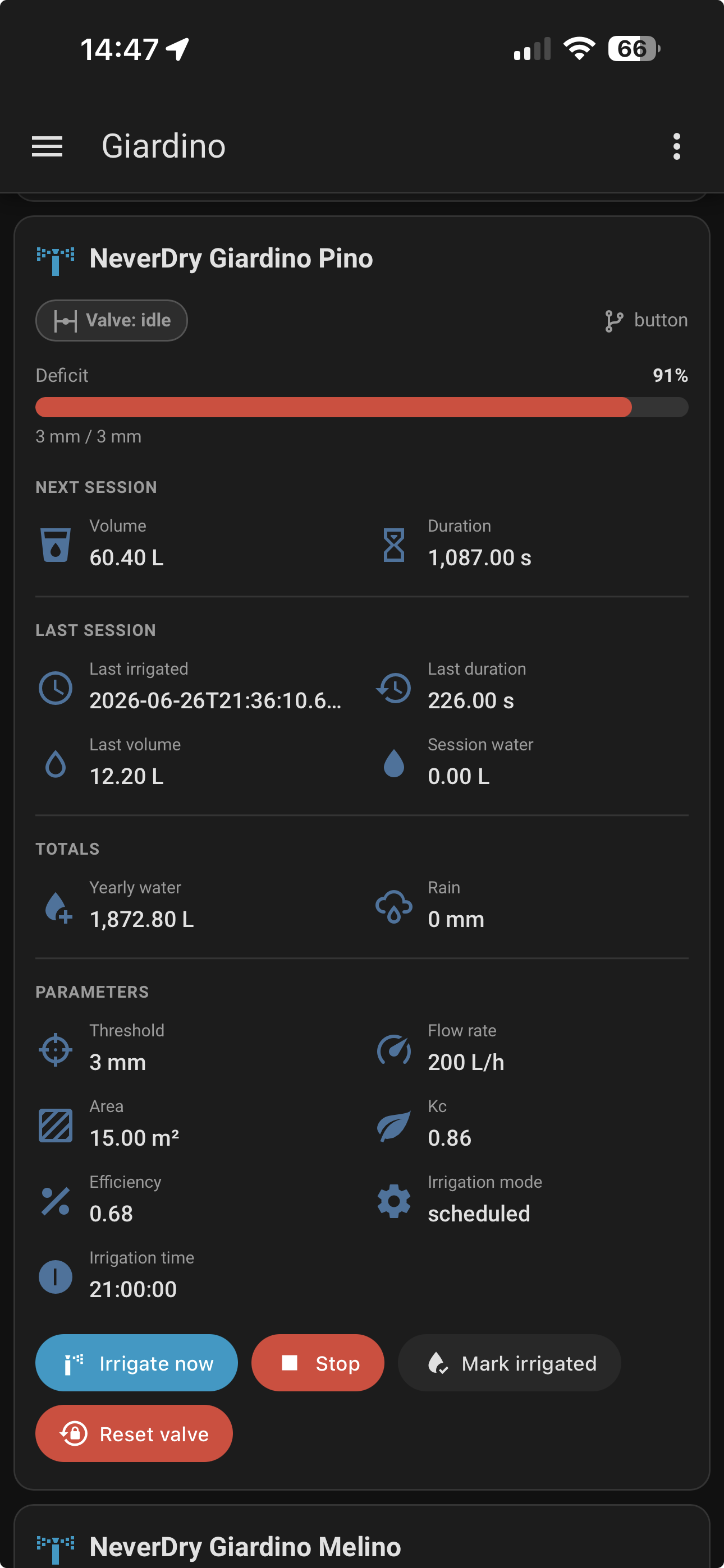

Small update — NeverDry now ships with its own dashboard card :seedling:
The most common question here was "how do I see all my zones at a glance?", so v0.10.7 adds the NeverDry Zone Card — a Lovelace card bundled with the integration that shows every zone in one place:
  • Current water deficit and status chips per zone
  • Next watering and estimated duration
  • Flow rate, now displayed in L/h (gal/h in imperial)
It's registered automatically — no manual resource setup, no YAML. After updating, just add the "NeverDry Zone Card" from the dashboard card picker (hard-refresh your browser once so HA loads the new resource).
Also in v0.10.7:
  • Full SI / imperial unit support across the config flow and runtime
  • Per-zone valve stop, with correct handling when a valve is closed externally or by hardware
  • More accurate water accounting and rain-event de-duplication
Update straight from HACS. Screenshot below :backhand_index_pointing_down:
Links
As always, feedback and screenshots from your own setups are very welcome.
