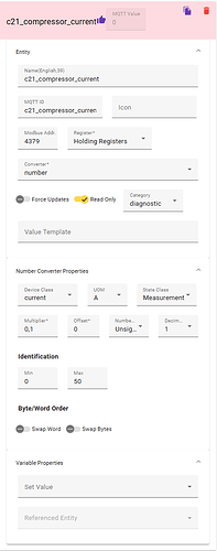

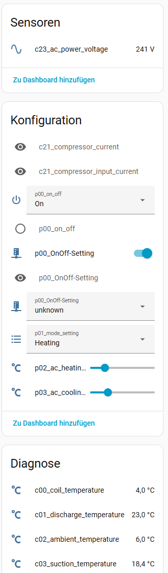

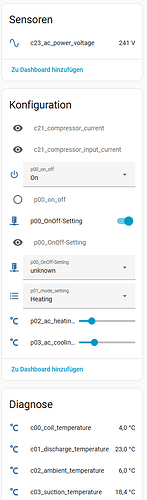

I tried adding my AWARMA 290 V3 heat pump to the list and I am stuck with a few problems:
  1. Sensors are spread around “Sensors” and “Diags” at will, no way to change that: I Added all entities the same way, suddenly some unimportant show up as Sensors and some real seonsors just stick in Diags.
  2. Some read only sensors are shown as Konfiguration, probably because of their names?
    “C23 Compressor Input Current” was set to be an input even I defined it as “Diags”.

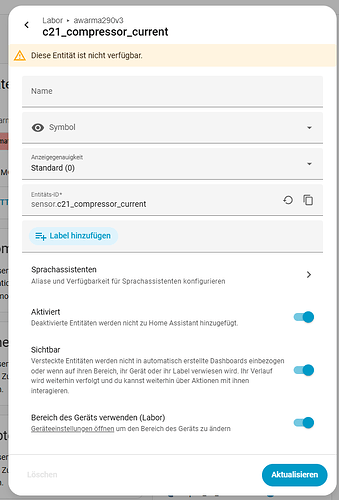

  3. Removing or renaming entities leads to dead tails.
    Along the investigation of how to make “C23 Compressor Input Current” an diagnosis data instead of a setting (or at least a sensor), the renamed left overs are now stuck as greyed out items.Unfortunately even the extended settings of these entities do not allow removal.
    The p00_on_off setting has the same problem.
  4. I cannot get any topic to be a control element.
    To my knowledge there are
    “Control Elements” to control things.
    “Sensors” to measure things
    “Configuration” to set important things up
    “Diagnosis” entities to read out helpful things.
    I am not sure if that is possible with Modbus, but I can’t arrange things as needed.
    Here is the compressor current for reference:
