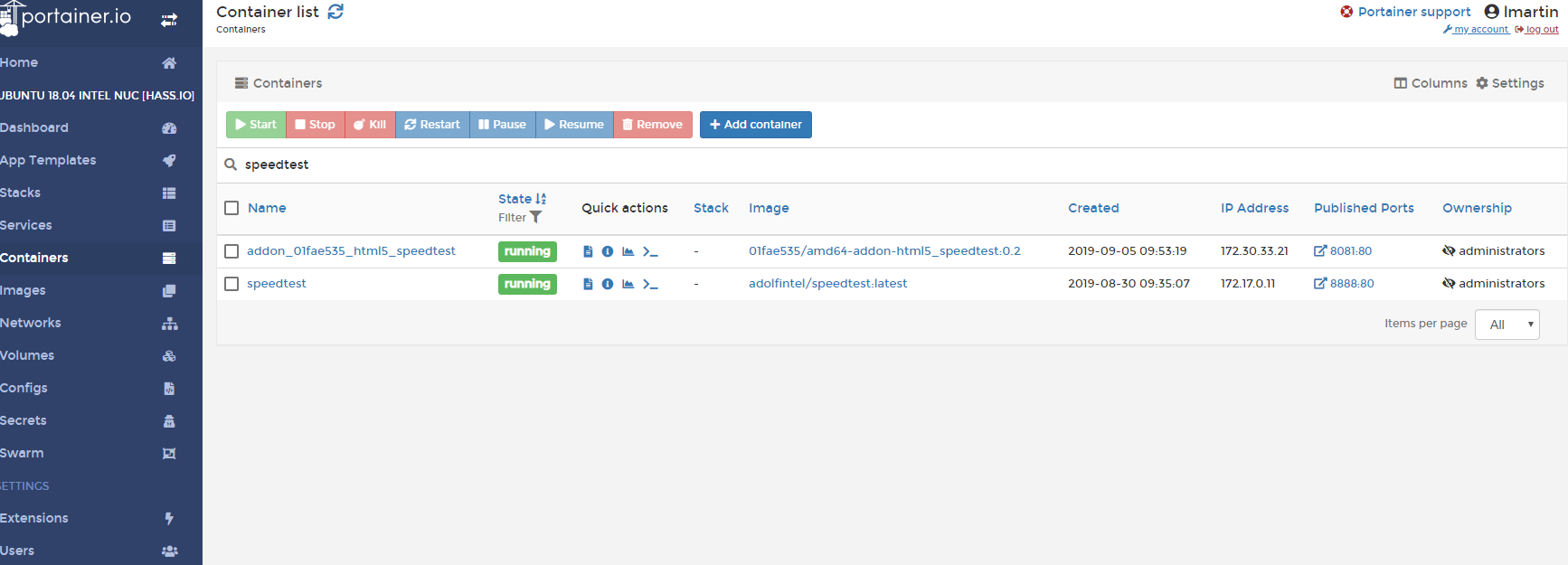

hey so this is interesting, I had been running this through regular docker for months, but after converting to an addon I didnt pay attention to the test results, just that it ran. I just realied though, that via ethernet, its only getting <100mbps results when its running as an addon, while at the same time running directly as a docker container on the SAME HOST i get the correct results…
Here it is on hassio
and here it is on the SAME HOST but not through hassio
why the heck is the one running as an addon being so limited in performance…
update: figured it out, its limited when run through the HA UI, dont understand why its affected so much, but I might remove the ingress support as its kinda defeating the purpose of the addon…
