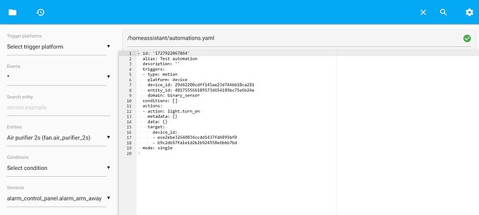

I created a new Automation, configured all the details, and saved it. However, when I go to the main Automation page, the new entry I just created is not showing. I checked the automations.yaml file and found the newly created entry, but I don’t understand why it’s not showing on the Automation page. How can I fix this issue?
hen viewing the automation in the automations.yaml file does it have an id and an alias at the top ?:-

it’s automations.yaml
