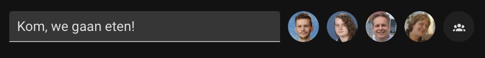

Thanks for this great component, and you helping me improve my home announcement widget. It allows us to send messages to the dashboard to each individual room or to all rooms at once, using tts to Google Home devices:
I also used UIX to make a foundry, which wraps this in a component I can reuse.
Which buttons are shown can be set by parameters, so I can put one in each room dashboard with only the appropriate button. This is the code for the uix foundry:
