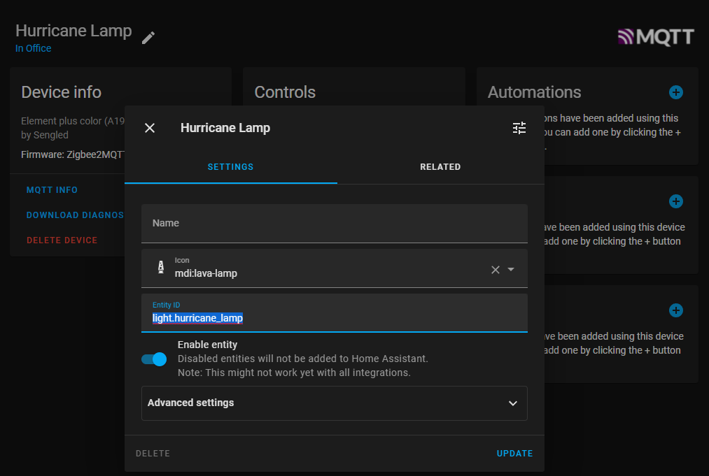

You can change entity IDs associated with a given device under the device or entity itself in the configuration panel. After you associate a new ZigBee device - just go in and make sure it’s entity ID matches the OLD entity ID - Everything else in HA keys on the entity ID so once you update the device to use the old ID everything should just work.
This fixture has a Sengled bulb - when I add it Z2MQTT usually brings it in with an entity ID something like ‘light.rgb_01234.’ The name doesn’t really matter - becasue I IMMEDIATELY rename it to light.hurricane_lamp and I’ve done it all 6 times ive replaced this particular bulb.
If you are using the device in your automations thenbthere us nothing you can do but change each automation with the new device id.
But if you use entity id’s you can change the new entity ids to match the old ones and you won’t need to touch the automations.
