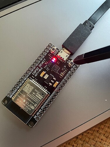

So i actually had had this happen to me as well using an MH-ET Live DEVKIT from Ali Express
In case you were banging your head against the wall like i was, this was the exact steps I had to do to get it flashed:
  1. Get to https://web.esphome.io/
  2. Connect your device, and click “Prepare for Adoption”
  3. Hold down the “BOOT” button as you click the button to install. This part was finicky as the error Installation failed: Error: Command failure error code 0x07 kept showing up. Had to hold the button before/during/after clicking “Make adoptable” and “Retry” for it to stick.
  4. As it installs, you can relax from pressing “BOOT”
  5. Before it reaches 100%, make sure to go back to holding “BOOT” again, otherwise you potentially get a different error Installation failed: SlipReadError: Timed out waiting for packet header
  6. Once you get “:tada: Congratulations”, click on “Logs”.
  7. Here’s the punchline: If you don’t see any console logs, press the “EN” to reset the device. You should start seeing information about wifi signals and other good stuff.
If you do get stuck on 5 (i have once), see if you can still go to “Logs”, and click “Reset Device” to see if things work out that way.
I had already installed the CH341 drivers, as mentioned above. Not sure if it’s that important, but worth having it.
Good luck!
