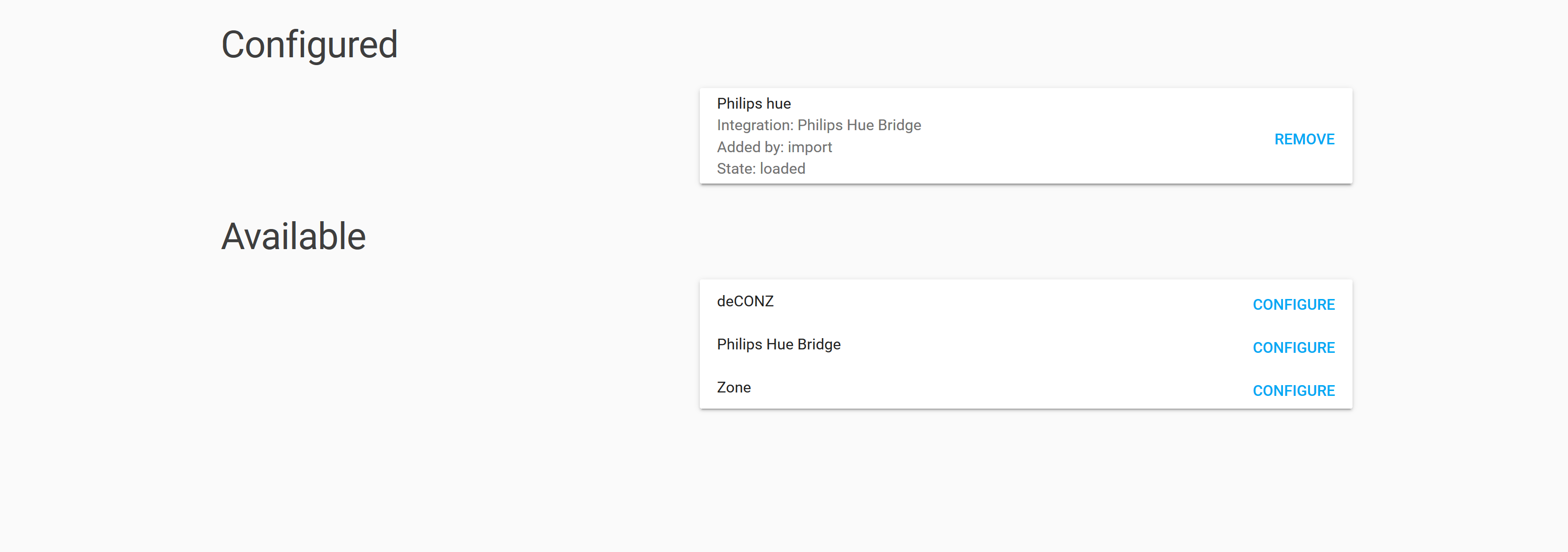

“Available” showing
a) deCONZ - Which I don’t have. Why is this here?
b) Philips Hue Bridge - What’s difference between this and one already configured?
c) Zone - Not sure why this is here as I don’t have zones configured.
Why not. But My Hue Bridge is already configured, I don’t have DeCONZ device and don’t use Zone feature. So I expect to have no new notification. There is perhaps a bug in the implementation.
I also have this. The Integrations page shows that I have “Philips hue” configured (which is correct), but shows the following as Available, but not configured:
deCONZ
Philips Hue Bridge
Zone
I’m unclear on whether the configured “Philips hue” and the unconfigured “Philips Hue Bridge” are the same thing or not, and whether I should be removing the former and configuring the latter. I’m also using zones, so I’m unclear on what the unconfigured “Zone” is for. And I didn’t even know what deCONZ was until this message appeared, so I’m pretty sure I haven’t added any new Zigbee devices.
