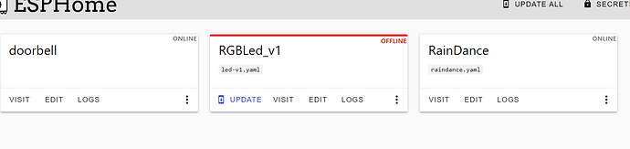

The device is showing online in the ESPHome dashboard. Both logifiles as wel as the webpage can be accessed without issues. (HA and devices are in the same network)

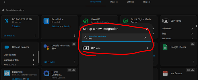

Did you add it in devices and integration?

The newly created device (RainDance) is online in the ESPHome, but not discoved / shown as a device

You need to add the node:
You will need to go into integrations and add it before it will show up. As Hellis81 was trying to say.
