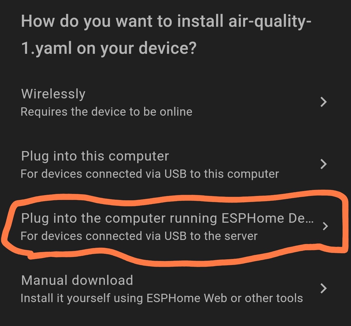

Try connecting the esp to your computer running HA/ ESPHome add-on via usb and try this option.
