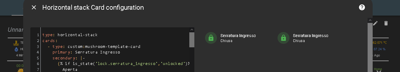

I am not pro in this matter but I think, to make all such mods to a card I have to use:
custom:mushroom-template-card
and when I use it⦠card occupy all the spaceā¦
ok, yes nothing wrong with mushroom-cards, i use them my self but for cards with many templates i turned over to custom:button-card, one can use grids also, and set height/width on the card
can you please help me with the code to obtain about the same graphic result on this lock door?
Wait for the coming changes/features, in the link Steven posted above, might solve your issue ( as Paul, the author of mushroom, atleast will ad features to the Section-View, and cards, like tile, and most likely some of mushroom-cards
btw , by default mushroom cards fill the available space, so if you only place 1 in a row, it fills the row, same as if you only put 1 card in a grid-cell, or a horizontal/vertical stack
But first of all, you donāt seem to be familiar with with the 4-Year-old-no-changes-card ( with btw, alot other alternative for the same )
So IF you take time to read the GitHub page, card configurations/features/examples(the very first example), i think you would not have to open this Topic, and blame New Experimental Dashboard, beside open a ābug reportā
by default Stack-in-card is Vertical, meaning card under card under card
Horizontal means side by side by side
type: horizontal-stack
cards:
primary: Serratura Ingresso

thanks for your help but it is not what I wantā¦
the reason why I use stack in custom is that I want to have lock icon red when closed and green when open, and I want to see battery level⦠is ther a way to change the normal card in that way without use custo m card?
You initially post was sizing of a mushroom card in a grid-cell.
with horizontal-stack(or stack-in-card#horizontal) you get the 2 cards, beside each other.
Sorry i donāt have any lock card, and btw stack-in-card has nothing to do with this, stack/grid cards are just place holders, for the āorigā card.
whatās wrong with mushroom ?
Changing color can either be accomplished with template , card-mod or Theme settings, if the native/custom card doesnāt provide this option.
If you havenāt got much experience in ānested cardsā the only native card i can think of is Picture-elements card , IF you want additional sensors in the card.
With a little fantasy/creative mind, you can add anything to it.
and with nested cards in a grid cell(or grid in grid), you can use 2-4 Tile-cards, and make it look like 1. And they have alot of default options, such as different colors etc
