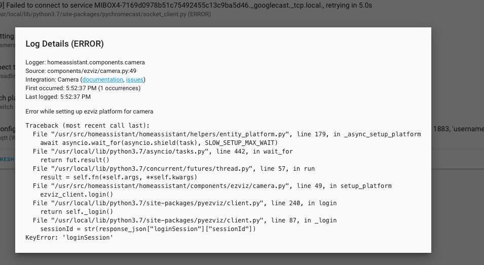

This is the error I’m receiving.
File “/usr/src/homeassistant/homeassistant/helpers/entity_platform.py”, line 179, in _async_setup_platform
await asyncio.wait_for(asyncio.shield(task), SLOW_SETUP_MAX_WAIT)
File “/usr/local/lib/python3.7/asyncio/tasks.py”, line 442, in wait_for
return fut.result()
File “/usr/local/lib/python3.7/concurrent/futures/thread.py”, line 57, in run
File “/usr/src/homeassistant/homeassistant/components/ezviz/camera.py”, line 49, in setup_platform
ezviz_client.login()
File “/usr/local/lib/python3.7/site-packages/pyezviz/client.py”, line 240, in login
return self._login()
File “/usr/local/lib/python3.7/site-packages/pyezviz/client.py”, line 87, in _login
sessionId = str(response_json[“loginSession”][“sessionId”])
KeyError: ‘loginSession’

## Logboekdetails ( ERROR )
Logger: homeassistant.components.camera
Source: components/ezviz/camera.py:49
Integration: Camera ([documentation](https://www.home-assistant.io/integrations/camera), [issues](https://github.com/home-assistant/home-assistant/issues?q=is%3Aissue+is%3Aopen+label%3A%22integration%3A+camera%22))
First occurred: 19:22:51 (1 occurrences)
Last logged: 19:22:51
Error while setting up ezviz platform for camera
Traceback (most recent call last): File "/usr/src/homeassistant/homeassistant/helpers/entity_platform.py", line 179, in _async_setup_platform await asyncio.wait_for(asyncio.shield(task), SLOW_SETUP_MAX_WAIT) File "/usr/local/lib/python3.7/asyncio/tasks.py", line 442, in wait_for return fut.result() File "/usr/local/lib/python3.7/concurrent/futures/thread.py", line 57, in run result = self.fn(*self.args, **self.kwargs) File "/usr/src/homeassistant/homeassistant/components/ezviz/camera.py", line 49, in setup_platform ezviz_client.login() File "/usr/local/lib/python3.7/site-packages/pyezviz/client.py", line 240, in login return self._login() File "/usr/local/lib/python3.7/site-packages/pyezviz/client.py", line 87, in _login sessionId = str(response_json["loginSession"]["sessionId"]) KeyError: 'loginSession'

I’ve some news, if the error is in the line 49 (loginSession) the issue could be the option “Access Configuration” in the ezviz account.
You can try to disable it on the ezviz website under “System Management > Access Configuraiton > Disable”
After this change my log change in:
