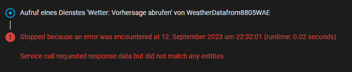

New Forecast Service, how i can create a forecast entity?
When you get a chance update your sensor to use the new forecast option and see if the card changes.
Nope, first test fail :thinking:
Test with RESTfulSensor
You don’t need to call the service in the card. The card has been updated to do that automatically.
Just put your newly made entity there, the one that has no forecast attribute.
Do you still see the forecast in the card?

What is the template you used in forecast_daily_template?
If that’s the template you used then I suggest you change it to this:
forecast_daily_template: "{{ state_attr('sensor.weatherdatafrom8805wae', 'forecast') }}"
Be sure to execute Developer Tools > YAML > Reload Template entities after making any changes to the configuration of weather.home_weather_station.
After you make the suggested change, post the revised configuration so we can review it.
