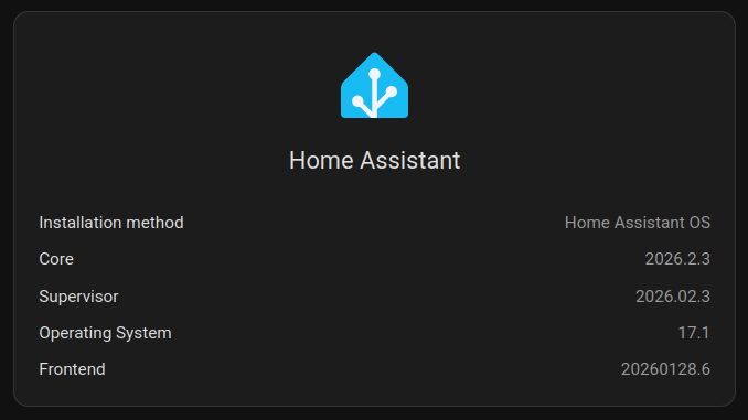

Decided to switch from Samba to NFS and gave this App a try. It was super easy to configure and get it up and running.
One problem though: I cannot export the addon_configs folder.
Running HAOS with the following versions
App config

Any idea why addon_configs is not mounted?
I spotted that myself on the weekend. I have just pushed v1.0.1 that fixes the missing export.
That did it, it works now! Thank you so much!
Great i’m glad it worked. Thanks for the confirmation.
