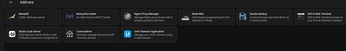

this is the addons list
and I take it, HACS is not impaired by a docker installation, right?

lots of the stuff running inside HA now would absolutly make sense runing on the host.
just think about the maria DB, no size limit, and nativ on the host OS, I think that would be quite a bit faster than now behind two virtualisations and with quite some restictions regarding memory right now. and the host has mariaDB anyway for its history… just like HA.
nginx no big issue
the mqtt broker, no clue, never set that one up before, but I gues there is a docker container that i could just put into the OMV docker enviroment and be hapy with it.
same goes with unifi network tool
How ever I need to have at least two windows VMs and one playground ubuntu, so I need to go the KVM route anyway, but I did read somewhere that the KVM VMs dont start automated after a server reboot, so I am a bit hesitant to put HA inside such a VM.
