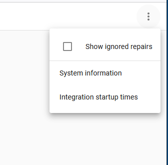

Start → System → Repairs → 3dots in upper right corner → Integration startup times
