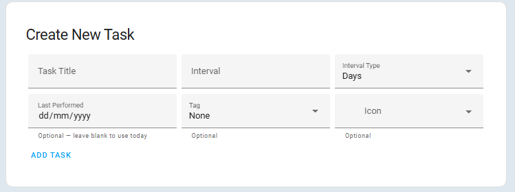

:toolbox: Features
  • Define tasks with a title, interval (days/weeks/months), and last performed date
  • Each task appears as a binary sensor that’s on when the task is due
  • View and manage tasks from a simple built-in UI panel
  • Mark tasks complete and have them auto-reset based on the defined interval
  • Data is stored in Home Assistant’s native .storage system—no YAML required
  • Fully supports automations, Lovelace cards, and notifications

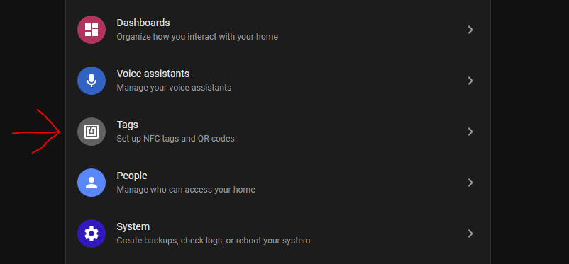

I didnt see anything to manage TAGs, is it possible?
Looks like that’s a bug likely introduced with fixing the screen refresh issue. I’ll open a bug and take a look
This is fixed in the latest version

I saw that the Tag feature should have been fixed in a previous release, but I has never really disappeared for me and also still present in the latest release:
When you select the dropdown it just shows “Loading…” and never retrieves the tag list?

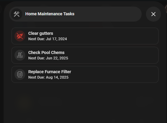

For those that are interested, here is another way to display these tasks in the UI. I’m using just a mushroom template card to show if there are any tasks due and on click it opens a Bubble card popup that shows all the tasks and any that are due are at the top.
This does require some HACS cards:
  • auto-entities
  • card_mod
  • layout-card
  • Bubble Card
  • Mushroom
Popup card yaml

Nope, never shows anything nor an option to add something
I’ve created a similar setup with a mushroom template card and auto-entities to only show task that are upcoming in the next 7 days.
This used the Easy Time library (GitHub - Petro31/easy-time-jinja: Easy Time calculations for Home Assistant templates) to show the relative time differences
Result:
Code:

If it shows nothing that means it completed loading the tags.
To be clear this is for NFC tags to associate the scanning of the tag with marking it complete. Not labels or category and there isn’t an option to add them from this UI that has to be done in the HA config.
Ahh yes then it makes perfect sense, since I do not use this.
Could not find any reference of it in the documentation of your integration. Maybe good to note that this if for NFC tags.
