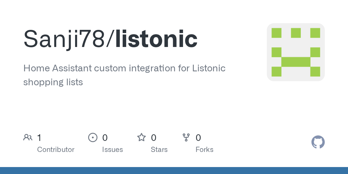

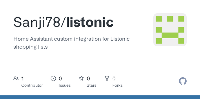

This is my custom component for Listonic:
Please consider buying me a coffee if you like my job
Thanks for the work my man, are you looking into getting the icons and the list for recent and popular? I really miss that, and I’d you have that you really earned a coffee donation :muscle:
@hansen2411-netizen sorry, I don’t get your comment.
