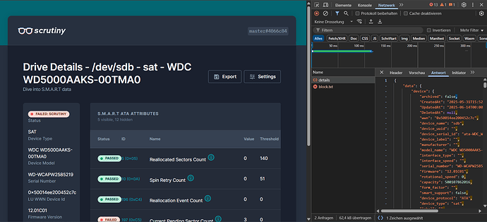

If not, it would be very helpful if you could send me the response-data of the Scrutiny API. This would help me to understand the difference to my data.
  1. open the Scrutiny webpage with the main summary dashboard (e.g. with Chrome-browser)
  2. press F12 to open the developers tools
  3. select there the “Network” tab
  4. then select in the Scrutiny dashboard one of the drives → it will change to the details overview of the selected drive
  5. in the network table you will see a new entry “details” → klick on it and select the tab “Answer”
  6. Here you should see answer data of the API in JSON format. Please copy the whole text and send it to me.
How it looks like:
Thank you!
