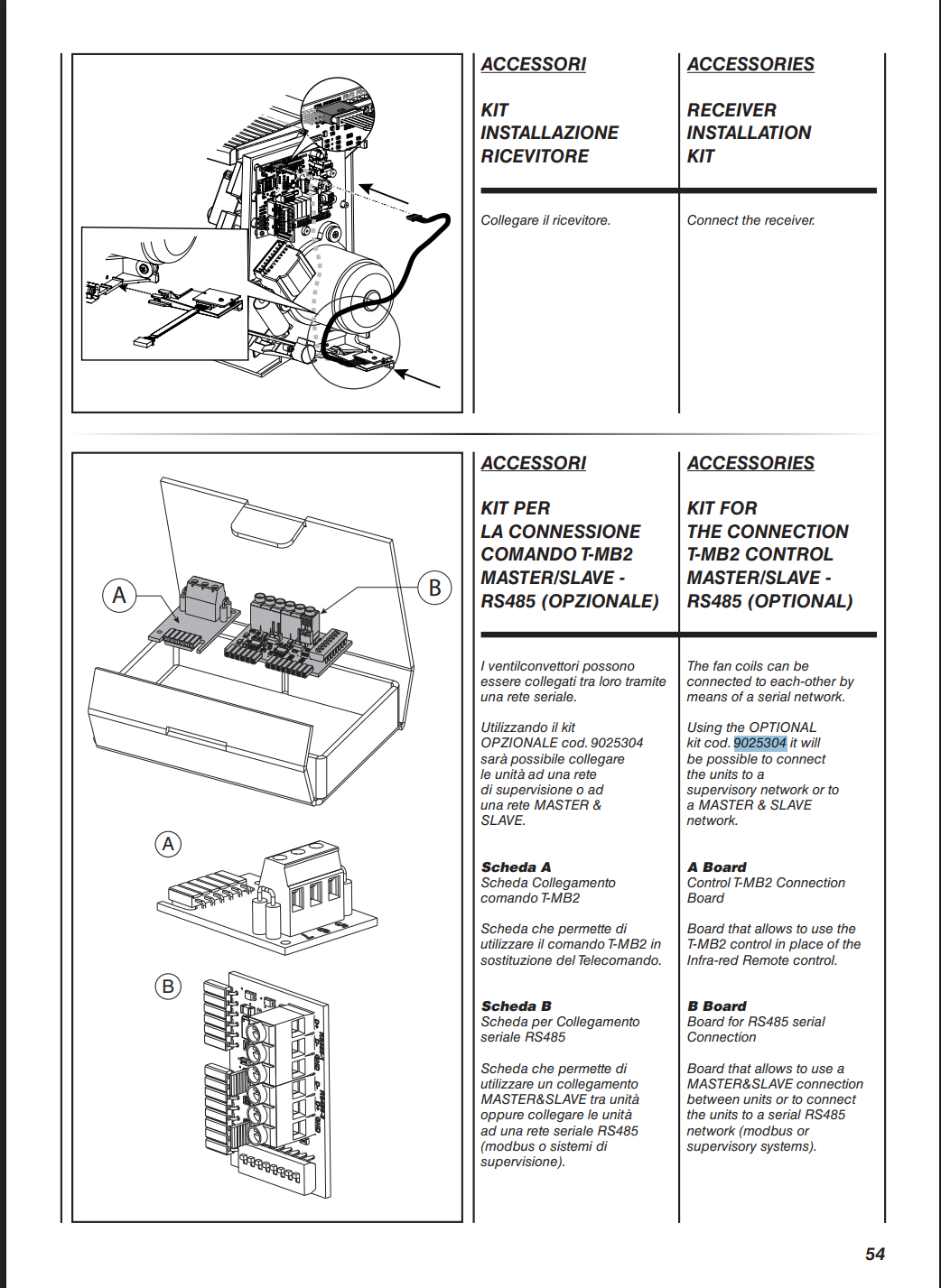

Note that this gen 2/WiFi unit has two Serial Interfaces on its PCB, one serial interface slot(M14-M15 on the PCB) will be used with my addon modbus(Part number MBA, the type B card), generating a modbus interface that I can control from a 3rd party control system.
The secondary serial interface is connected to a IR receiver by default. This slot is described as CTRL (M8 port).
You can use the unit with an external RS485/Modbus thermostat Eveco/Sabiana, called TMB2 connected to the M8 port, with an external modbuscard MBA, type a card). But when this is connected, you can not also use the IR(as the ir reciever eye is connected to the same port on motherboard PCB). I belive you can have one TMB2 thermostat connected to multiple fancoils.
I belive this is why some of the confusion, as there are two modbus interfaces on the fancoil, one for external contorl and one for external thermostat(which cannot be used in combination with the IR reciever/remote).

It seems that the only way to go forward would be with Modbus. I’m just wondering where I could get the Sabiana MBA kit since I don’t have the modbus version. The MBA kit should be optional accessory with product code 9025304.
I thought about installing only the “card B” from the MBA kit to M14-M15 so that I could still have the infrared control in the M8/CTRL INTERFACE port.
If I would install my unit to Slave mode, I guess it should get the commands via M14-M15 port RS485 with Modbus RTU and also listen to IR-commands from M8/CTRL INTERFACE.

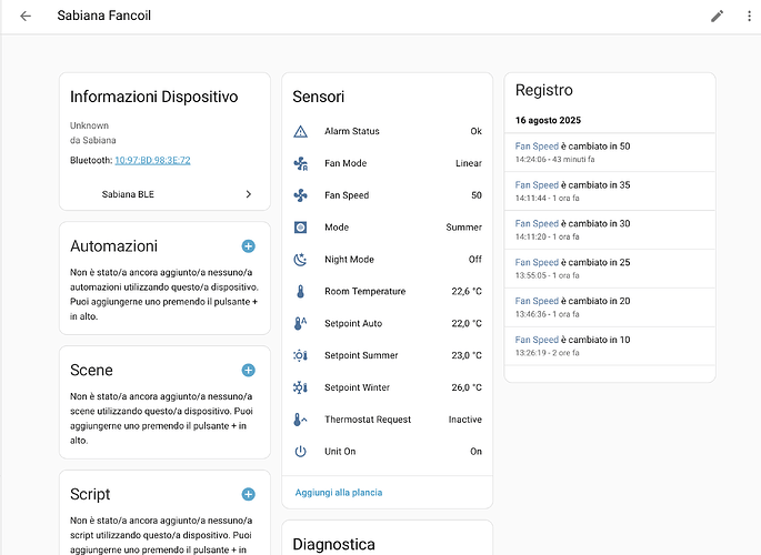

I am actually working on a BLE integration right now leveraging on the CB Touch smart command, with some good old reverse engineering (and Gemini too) to interpretate the data stream. Looks pretty feasible to me.
It is also possible to sniff Sabiana’s official APIs and implement them maybe using Node-RED but I prefer local integrations. As soon as I have something working, I will send you an update.

Does your models include WiFi and Bluetooth? Meaning, can you manage the device using Sabiana WiFi or Sabiana BLE apps? If so, the integration I am building could be your solution.
Right now, I managed to handle the secret token sharing and the reading of all parameters, I am working right now to implement the writings. As I said before, this looks feasible.

I am working on this integration as a relaxing job for my summer holiday break, so do not expect results anytime soon :sweat_smile: I am confident about the notification logic and the interpretation of the payload, I am now trying to understand how to write commands to the board.
As for Modbus, my board is shipped with RS485 ports and I was able to find online the technical sheet with all the registers. I know this is the Sabiana preferred way to integrate their products to existing systems, I once did a job for a company that did so.
But again, if BLE happens to be reliable, I think this could be the best way to accomplish this integration, wireless is always more convenient than wired (hopefully not too unreliable)
