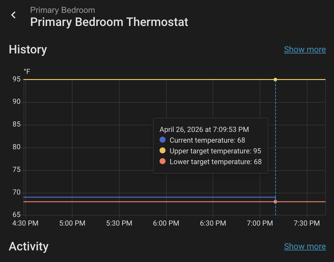

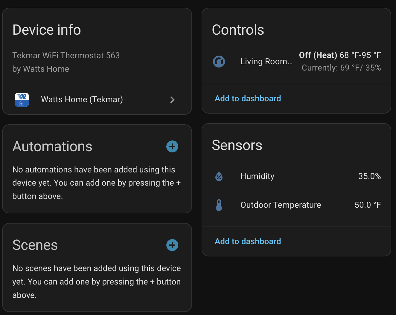

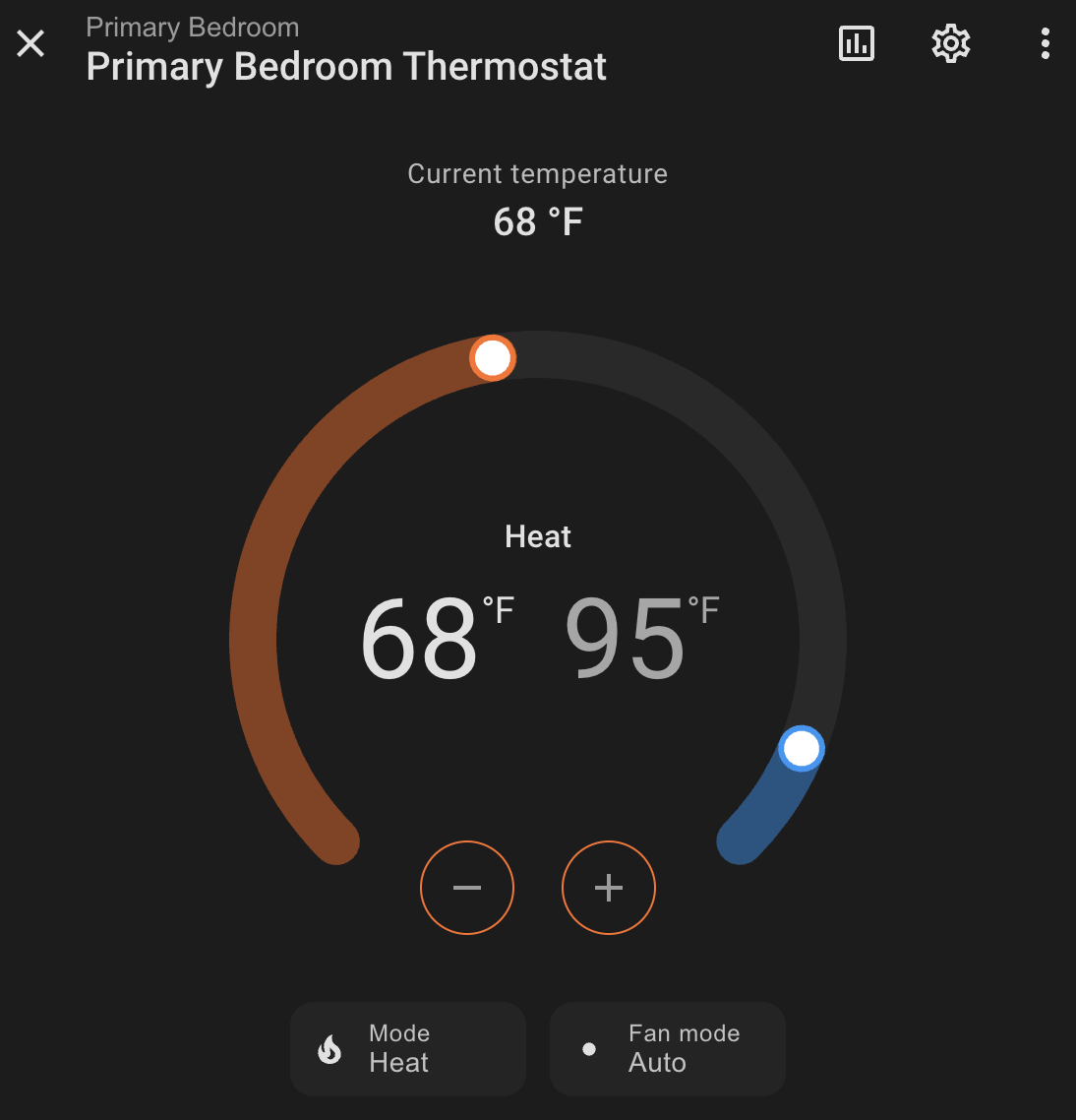

Screenshots:

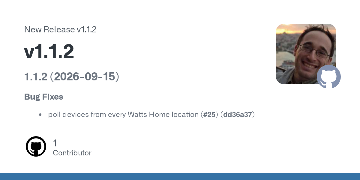

Thanks for the report! I filed Only the default Watts Home location is polled · Issue #24 · bhamiltoncx/ha-watts-home · GitHub and landed a fix in fix: poll devices from every Watts Home location by bhamiltoncx · Pull Request #25 · bhamiltoncx/ha-watts-home · GitHub .
I released the fix in v1.1.2. Enjoy!
