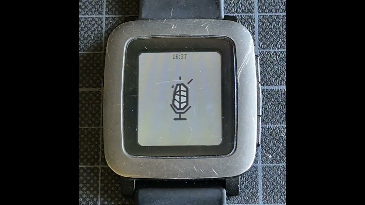

One thing that supposedly works, but for which I don’t have the HA setup to go with yet: “newer” pebble watches had built-in microphones, and the app seems to support that in combination with HA. Pretty amazing, as it completely circumvents the whole “how good does a mic need to be to cover a whole room” challenge.
Is there anyone in here who is already working with the app and has the microphone working with the new HA voice stuff?

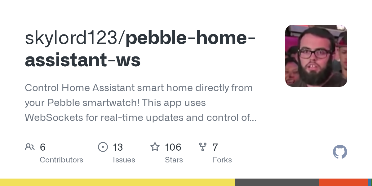

New Home Assistant App for Pebble
I’m also working on a new Home Assistant app for Pebble watches:
With full support for Assist pipelines! :slight_smile:
It’s not on the app store yet, but you can download the pbw files from the GitHub Actions tab and sideload them. I have a few more things to iron out before publishing to the rebble app store. More details are available in the Pebble Discord thread: Discord

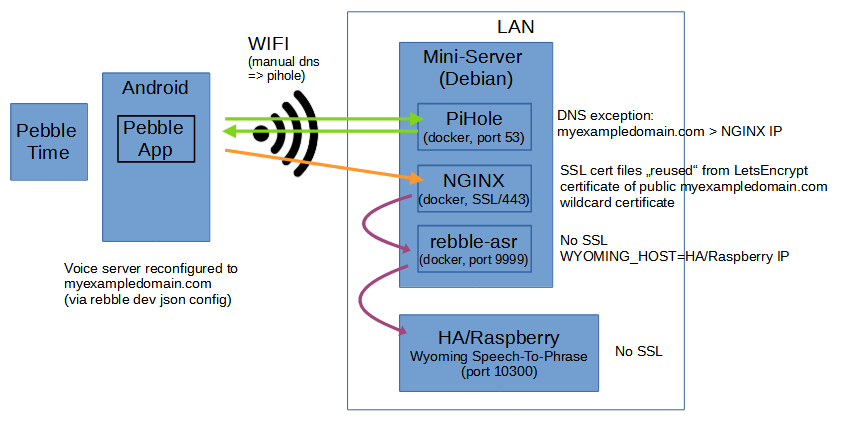

Okay, so here is how that played out for me when setting everything up:
What works:
  • I can voice-control my HA instance from my Pebble Time, completely local, re-using the speech-to-phrase addon on my HA instance
  • speech-to-phrase in the end from a technical side works like a less-capable speech-to-text service, so from a wyoming perspective it doesn’t make a difference if I use STT or STP via rebble-asr. ( @synesthesiam, just as feedback: the name “speech-to-phrase” initially made me believe that STP and STT work completely differently, especially from how they are used by other services. Took me a moment to figure out how it actually is :slight_smile: )
  • I had never used docker before, but despite the steap learning curve it was also just fun to figure things out step by step :slight_smile:
What doesn’t (fully) work:
  • the old Pebble app on my Android phone (Samsung S24, Android14) out of the box doesn’t use the local/manual DNS settings of my WiFi to resolve to the local IP which I added as a manual entry to PiHole. For now I have to use an extra app (PCAPdroid) that forces the traffic of the Pebble app through its local VPN, which as a side effect enforces the use of the Pihole DNS server. Very annoying overhead. Probably related to a network library used by the Pebble app, which prefers a Google DNS server over the manual DNS setting. Oh, and “Private DNS” needs to be switched off on the phone.
What kind of works:
  • SSL for rebble-asr by “reusing” the certificate of a public domain of mine, but without automatic certificate updates (see details further down)
My approach/setup:
the nginx.conf
user nginx;
worker_processes auto;
events {}
http {
include mime.types;
default_type application/octet-stream;
sendfile        on;
keepalive_timeout  65;
error_log  /var/log/nginx/error_log;
access_log  /var/log/nginx/access.log;
server {
    listen 443 ssl;
    server_name www.myexampledomain.com;
    ssl_certificate /etc/apache/ssl.crt/cert.pem;
    ssl_certificate_key /etc/apache/ssl.key/key.pem;
    ssl_protocols TLSv1.2 TLSv1.3;
    ssl_ciphers HIGH:!aNULL:!MD5;
    location / {
	    proxy_http_version 1.1;
	    proxy_cache_bypass $http_upgrade;
	    proxy_set_header Upgrade $http_upgrade;
	    proxy_set_header Connection $http_connection;
	    proxy_set_header Host $http_host;
	    proxy_set_header Authorization "";
	    proxy_pass http://192.168.1.28:9999; <= replace with IP of your docker host
The .env file for rebble-asr
ASR_API_PROVIDER=wyoming-whisper
WYOMING_HOST=192.168.1.13 <= replace with ip of your HA instance
WYOMING_PORT=10300
the JSON for rebble.io
“config”: {
“voice”: {
“languages”: [
“endpoint”: “www.myexampledomain.com”,
“six_char_locale”: “eng-GBR”,
“four_char_locale”: “en_GB”
“first_party_uuids”: [
How I got the SSL certificate working:
My domain hoster uses LetsEncrypt for SSL, and shows the content of the cert.pem and key.pem files in the admin area. I copypasted that into the respective files on the docker host, those are the ones I’m using in the nginx.conf.
The problem with that approach: the certificate on the local nginx will not automatically get updated, so I’ll have to copy the content over every few months until I have figured out something easier.
Also needed: manually exposing the wyoming port of the speech-to-phrase addon in HA.
So once the docker containers are running, and the VPN app on my phone is started, and the ASR setting in rebble is rerouted to the local service, this is how it works for me:
Open points aka ideas to work around the certificate and dns problems:
  1. set the public A record for an unused (sub)domain to a local IP (192.168.1…)
    => even when the local DNS is ignored, the public one would still return the correct local IP. When someone for whatever reason calls that subdomain from outside my LAN it will not work, or point to a local server running in their LAN. Doesn’t bother me.
  2. automatically pull the certificate files to avoid the need for manual copypasting
