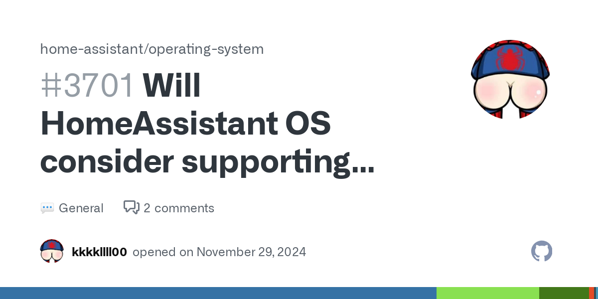

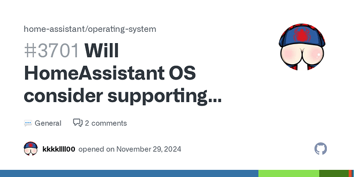

Adding this link to help future searchers. The comment thread has instructions for getting it working with Debian:
