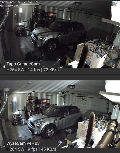

I have two Tapo cams and they’re easier to set up/deal with, but I like the low light image quality of the Wyze Outdoor Cam V4 better than the Tapo C100 even though I need to run the Docker Wyze Bridge Add-On:
Ooops - just saw the PTZ comment, sorry: neither of them is PTZ
