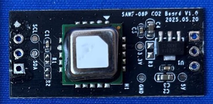

I found a device.report certification document which has a teardown of the matter/Wi-Fi devices. It seems like they have a common motherboard with an ESP32-D0WDR2-V3, which is also mentioned on the website. It looks like Sonoff is building two versions of the PM2.5 sensor model with different laser-based modules:
  • PM2.5 sensor: Plantower PMS9103M
  • Cubic PM2008M
The CO2 sensor daughter board doesn’t have any identifying information on the silk screen, but the mounted device ‘in a can’ looks like an I2C Sensirion AG SCD41-D-R1. The certification company cut everything open, including the can and removed the mesh.
I am not sure about the LCD controller, it has a 48 pin package, and it looks like it might be a Holtek HT1621 . I cannot be sure if the TM1621 LCD Display - ESPHome - Smart Home Made Simple library is compatible

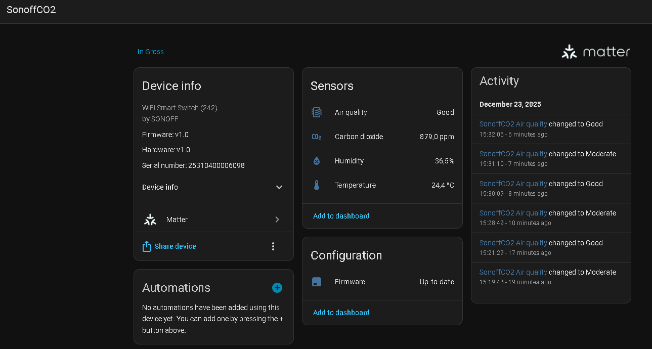

I just received mine. Its easily adding to HA via Matter - see screenshot what it offers. Funfact, HA thinks its a WIFI smart switch.
Compared to my selfmade and calibrated SDC30 sensors, the CO2 readings seem pretty solid, only humidity is way off by 20%, but the values can be calibrated manually on the unit itself.

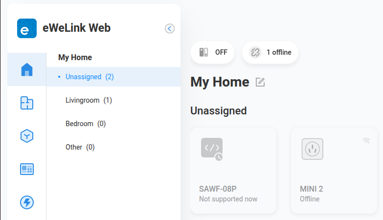

  4. Sonoff switches integrate easily with Home Assistant via eWeLink. However, as of now (January 2026), eWeLink does not pass sensor data to Home Assistant. Moreover, it appears that these data are not even sent to their own web service. An example can be seen in the screenshot (SAWF-08P). I’ll probably have to integrate it using Matter.

Looking at the 3 models, it makes me wonder whether one can buy the PM version and add the CO2 sensor
Based on the report @byb posted, the sensor used seems like it can be easily substituted with one of the many sensor PCBs using the same I2C sensor. Of course this would require being able to use ESPHome and it supporting all the components… unless the original firmware detects the sensor and “it just works” with both (assuming I2C addresses used match).
Might be this one:
This may also allow placing the sensor outside the main enclosure to get it farther away from the heat source… The one with the PM sensor, might be using the temp/humidity sensor that sometimes is inside PM sensors like the popular PM5003T

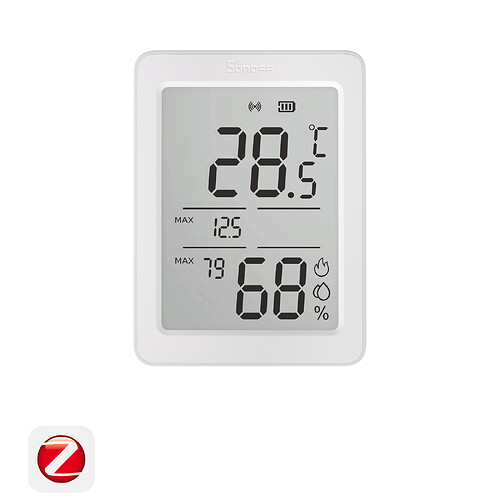

For the AirGuard TH (Zigbee version), has anyone tried to link it to an external sensor? It has that capability and Sonoff states that it requires a specific FW and a bridge - wondering if this is something that can also be achieved with a Zigbee coordinator on HA, preferably ZHA? Very neat feature and I’m looking specifically for something that allows us to have easy outdoor readings at a physical, battery driven unit, and this would be perfect for that use case.
  • Supported devices for Temperatrue: AirGuard TH (require firmware v1.1.0 or above), SNZB-02P,SNZB-02D, SNZB-02WD, SNZB-02LD
  • The remote device must be connected to the same SONOFF Zigbee gateway, including: Bridge-P, Bridge-U, NSPanel Pro, iHost

I have no matter bridge and connected it via ewelink and then SONOFF HACS…but it has no eneties…

@masoos To let you know and anyone else stumble upon this thread. Do not add the device via ewwlink. Just use the mobile Home Assistant app and add a new device (Matter integration). You will need to point the camera to the QR code at the back of the sensor.
