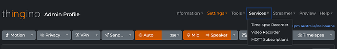

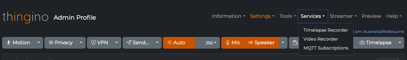

I have installed the most recent version of the FW that I could find on GitHub, and yet I cannot see the native home assistant integration under the services menu.
