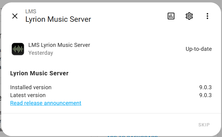

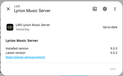

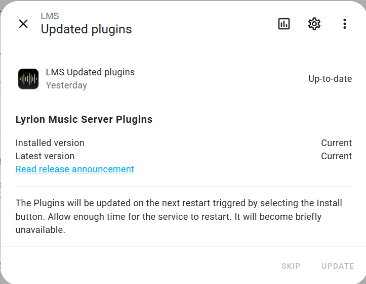

Update Platform
@pssc added a new update platform which adds entities to the LMS service which show if there are updates available your LMS and/or for your plugins.

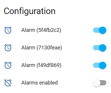

Alarm Support
One feature that’s been requested for a while is support for alarms. In 2025.6, we’ve introduced a switch platform and initial support for alarms. Initially, this is just support for turning individual alarms on and off, and the ability to disable or enable all alarms for a device.
We’re continuing discussions with the architecture team about the right way to extend the functionality and fully implement alarms, but for now hopefully you’ll find this useful.

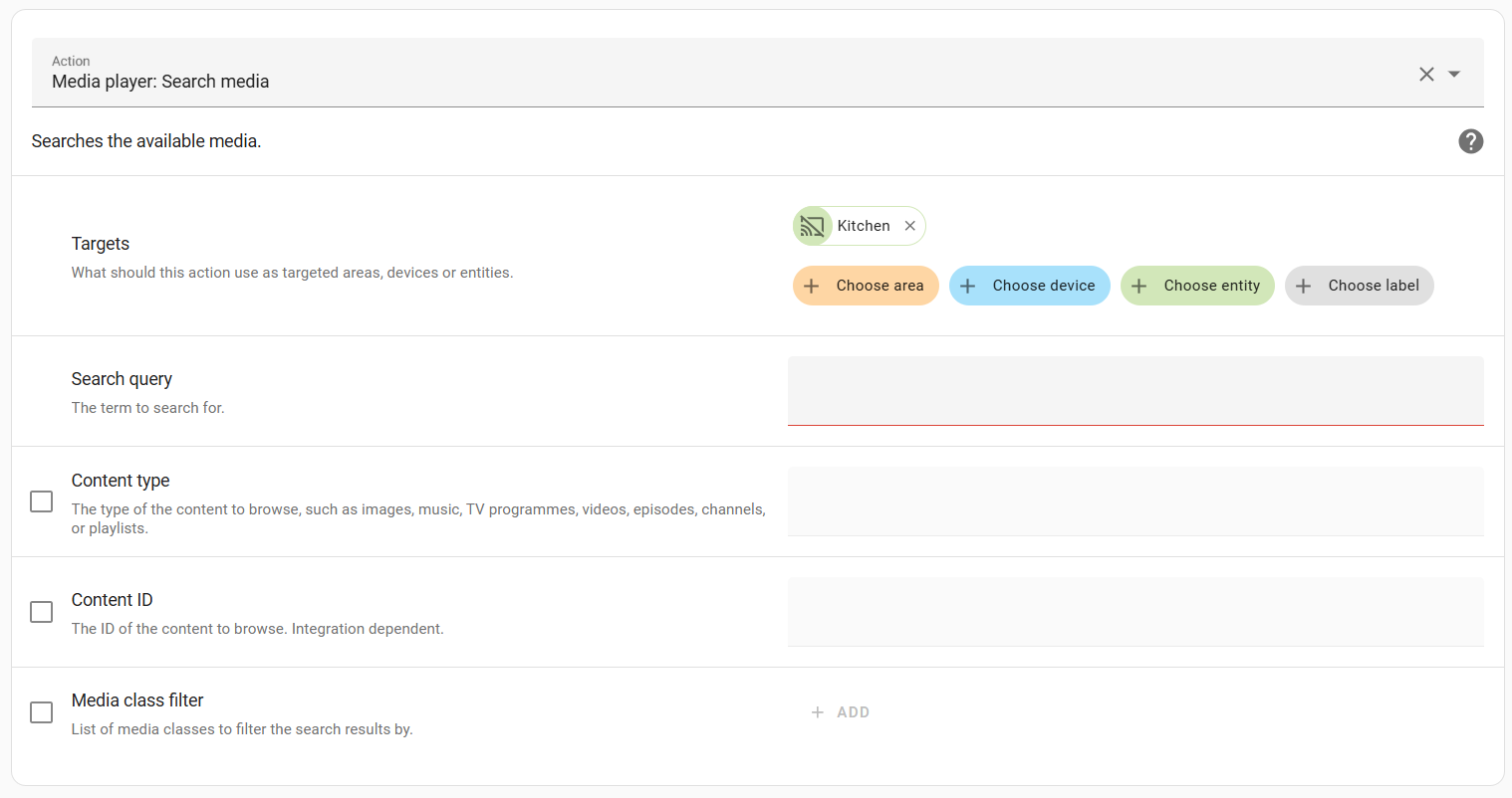

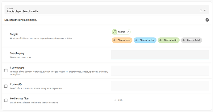

Search Media
In 2025.5 a new action, search_media, was added to the media_player and is now available for squeezebox media players. This action allows you to search the media library and will be particularly useful in implementing scripts and intents - i.e. the ability to search for a particular piece of media before then playing it.
You can specify a content type to choose where to search (e.g. albums, playlists, favorites etc.), and/or a media class filter to filter the result set (e.g. album, playlist etc.).
Any questions, please let us know.
Peter, Phil & Raj
@psketch, @pssc, @rajlaud

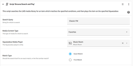

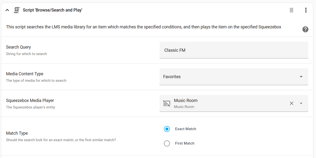

One of the uses of search_media will of course be to search for something and then play it. I wrote a script to make this easier, which you can call from other scripts and automations. It’s a bit more complex because searching for favorites returns a media_content_id which can’t be played directly, so instead we’re using browse_media rather than search_media for favorites.

As you’ll see, I’ve added fields to the script, so you can call it from other scripts and automations
If this is useful, I’ll create a blueprint.
