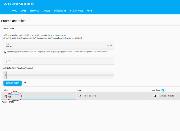

Saved the file, reloaded the template.yaml and even afterwards the complete yaml config, but still entities are not showned in the developper tools when I look for them :
… Nor in Parameters / devices and services :
Do you see what I have done wrong here ?

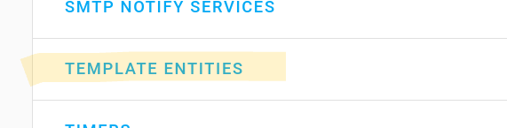

Are these two Template Sensors the first Template entities you have ever configured in your system or did you already have other ones that you configured previously?
The reason why I ask is because this appears in the Reload list only after the first Template entities have been created after a restart.
Screenshot_20240118-121453~2
When it appears in the Reload list, it allows you to load all additional Template configurations without requiring a restart.
So when you said you reloaded templates.yaml, what exactly did you do to make that happen? Because if you clicked Reload Template Entities, that should have worked (because that’s the whole point of that command).
To recap, it’s only necessary to restart Home Assistant if it’s the first time you create a Template entity (in YAML). Afterwards, the Reload Template Entities command will reload existing Template entities and load new ones (i.e. a full restart isn’t required).
